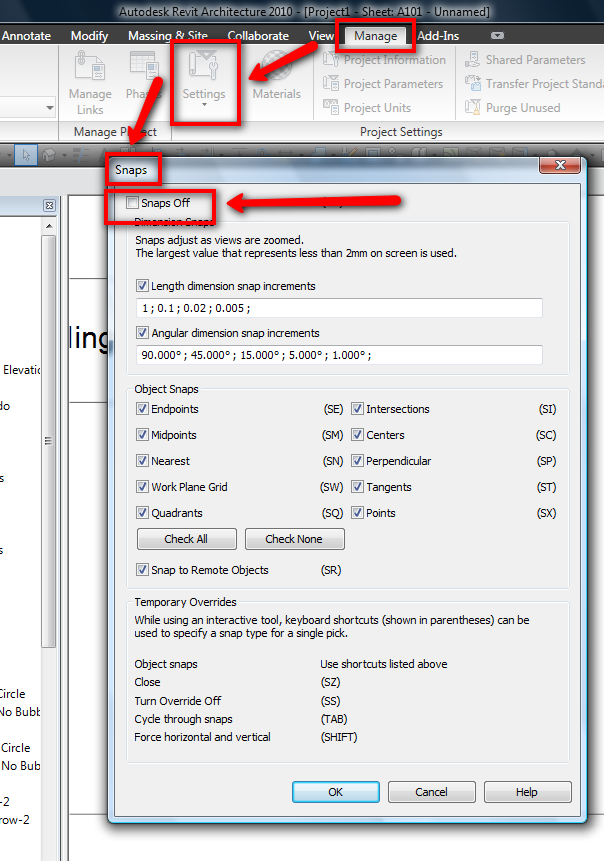

Is that an "Image" or a 2D annotation Family??? no matter, pick, go to "move" and drag where ever you want.... Did you have the "Snaps Off"???

When you use the "move/Copy..." command use the "TAB" key to "jump" to differents snaps (endpoint, midpoint, intersection...)

it's a 2D annotation (created by modifying the original "View Title" family) and my snap setting match exactely the settings of your screen shot.
