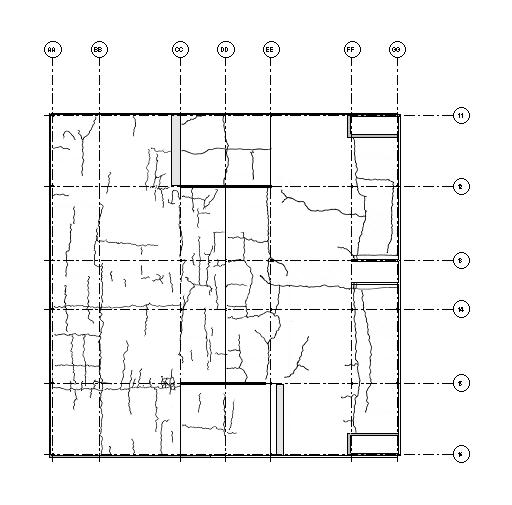

 So, on every plan has an image in the background and every print preview shows the image. But, when it is printed all the plans print with the images except for one. I cannot for the life of me figure out why this one plan is any different than the others.

Could you give more info on this... maybe release an image or two??
 Is this an image on a sheet, in a view on a sheet, in a family.......?

Here I did a survey of an existing parking garage. I scanned in my notes and used them as a background instead of redrawing them in Revit. All the scans show up in the sheets and in the plot preview. All of them plot with the scans except for the second level. I have swapped the scan on the second level for other scans, but they still don't plot. I've insterted the second level scan into other levels and it plots fine. Why won't the second level plot with the scan?

Strange.  Try the following:
Create a view template from a view that works and apply that to the second level.
If that doesn't work then try and duplicate the view with detailing.
If that doesn't work then create a new plan and copy and paste 'same place' all of the othere details from the second level (but not the image) and reinsert the image.

Applying a template from another level didn't work.
Duplicate view w/ detailing didn't work.
And (I can hardly believe it, because I was sure it would, but) creating a new level didn't work. WTF Chuck?

Problem fixed, but mystery remains.
So, I deleted the new level and tried to insert the image again. This time I didn't scale the image, I just left it huge on the plan. I also turned off the crop so it would print the whole thing. And it did, I don't know why. So, I scaled it down and cropped it. And it printed. I've no ideat what is different from this than anything I've done ealier. I can only assume I beat Revit into submission.
