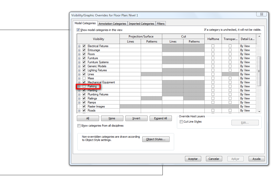

I have problem having the carparks and landscape visible on site plan. I couldn't draw it on site plan, thus I drew in on 3D view. It is vissible in 3D but not the site plan..Does anyone know what is going on here? How do I fix this?

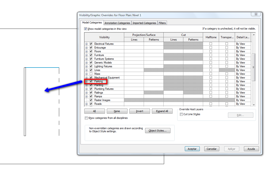

Do you have "parking" unchecked in your VG?.....

YES..
PARKING IS "TICKED"

First, you should be placing these in a plan view - not a 3D.  I don't believe these are site hosted so they are probably placed at a level.  Turn off your topagraphy and you will probably see them because they are below your grade.
