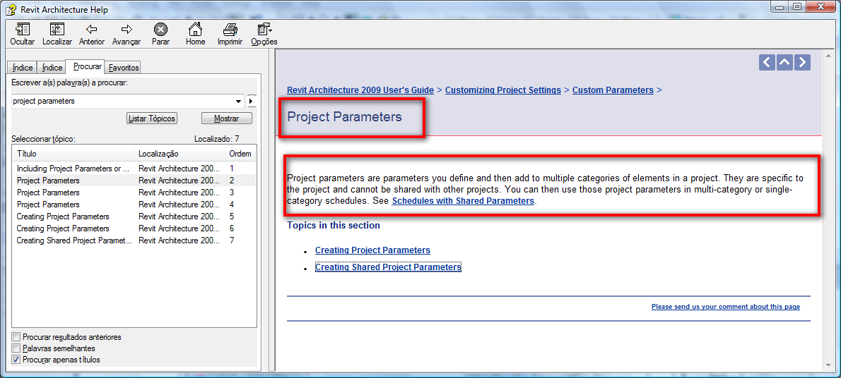

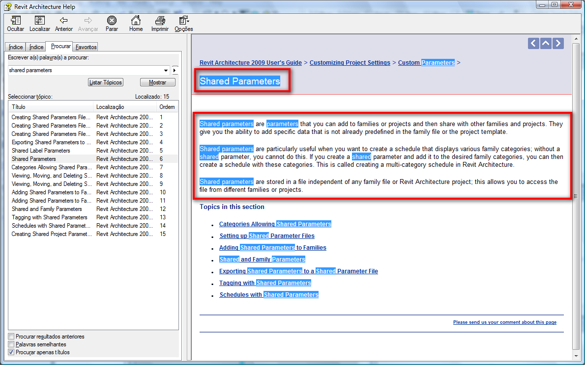

directly from the HELP menu:

Project parameters don't / can't control anything.  They are just added to families at the project level for scheduling purposes.  From the HELP: "User-defined fields .... are specific to the project and cannot be shared....<used> in multi-category or single-category schedules."

Shared parameters can be used across multiple projects and familes.
Could shared parameters be used to drive familes?  Yes - they already are.  Look at type tables.
