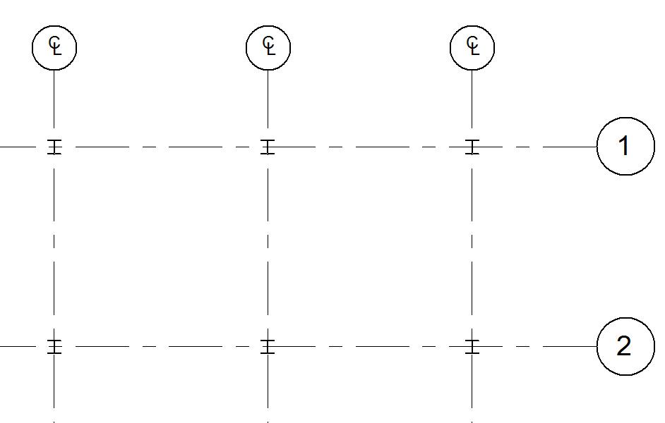

I am trying to change a column grid bubble on an enlarged elevation from the actual column line # to a bubble that reads "CL".  I have tried to load in the "Column Grid - Circle" family from the "Imperial Library --> Annotation" folder into Revit, but when I do so, it shows up as an option in neither DETAIL COMPONENTS nor SYMBOLS.
Any idea what the problem is here?  Are column grid bubble families loaded in somewhere else that I'm not thinking of?
Thanks!
 Cryingbtw, working in Revit 2009)

Is this what you mean?  If so, create a new bubble using the Grid head template, create the head that you require, load it into yor project.  Place a standard grid line in the project, go into it's properties, duplicate it and change the symbol to the one that you have created.
