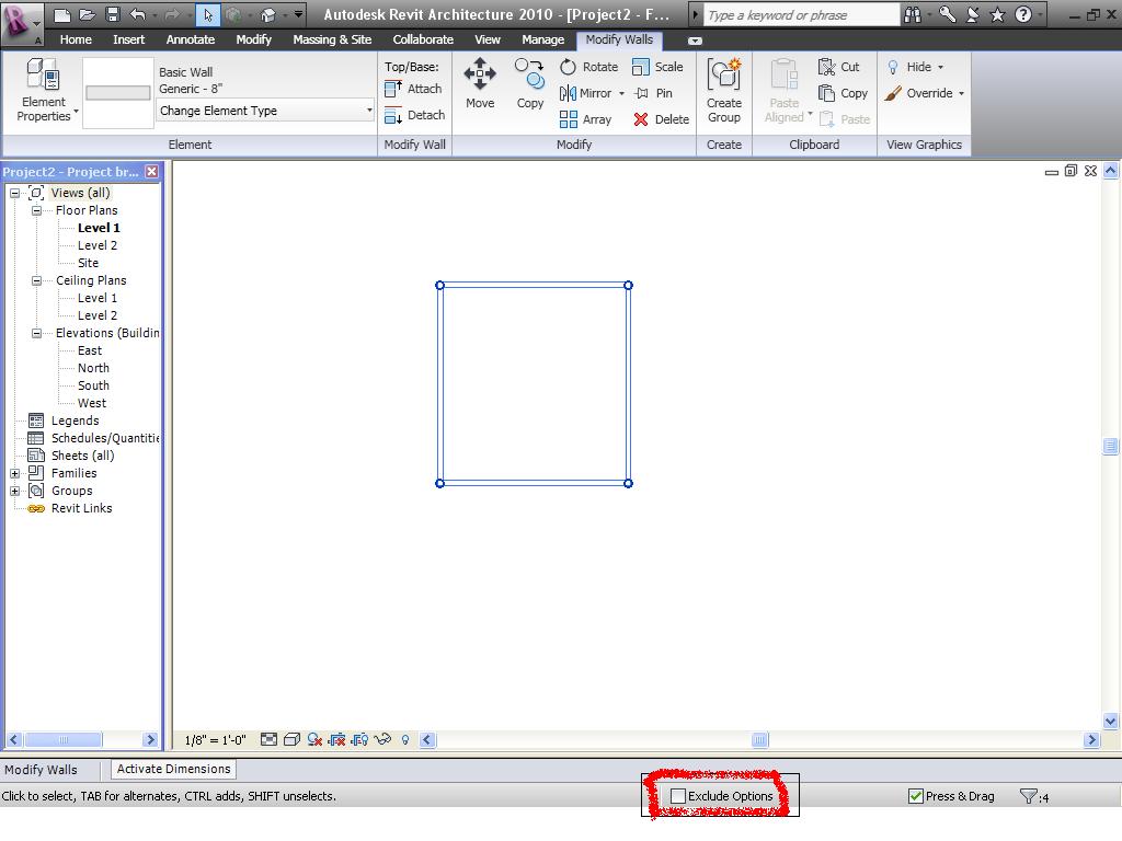

Does anyone know where the Exclude Design Options Button went in Revit 2010? Thanks

qabulin - that's not what he's looking for. i'm having the same issue. i find that check box useful when i need to select multiple things that are on varioius design options. has anyone found where it's at? did they remove this function?

It will be in the Options bar...may be top of your drawing area or bottom. Please check the attached image. qabulin please understand the question and reply. This is not the first time you did this.
