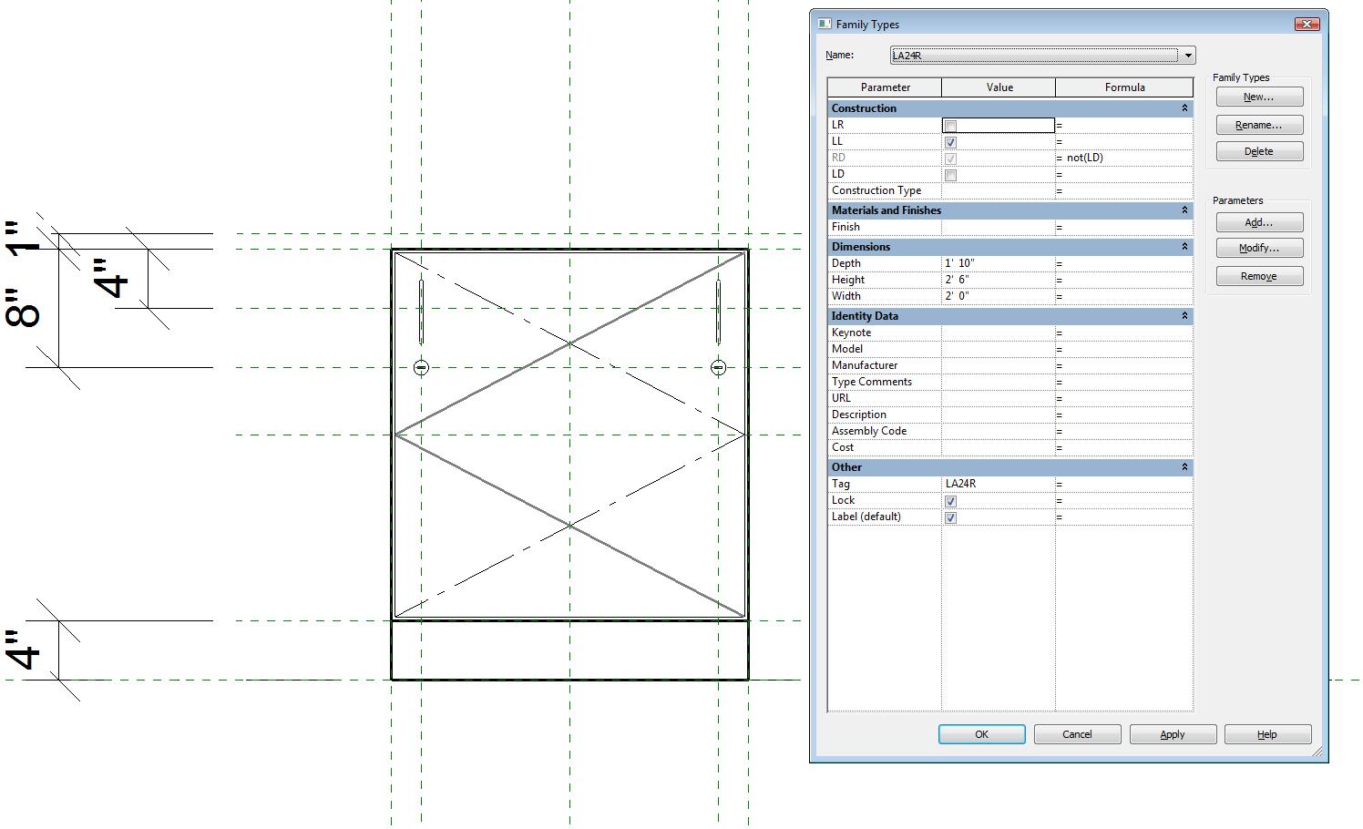

Need help! A formula perhaps: I have a situation where I have a base cabinet. The cabinet will have a RIGHT hinged door as a family type or a LEFT hinged door. For the handle I’m using a simple yes/no parameter to make the handle visible depending on which door is needed.  However, this base cabinet needs to be locked as an instance parameter as needed.  See image attached. When I check the Y/N “Lock” parameter below, I want the lock to show up correctly, Left or Right Doors. Right now I’m providing one left lock and one right lock, but both either turn on/off with the “Lock” parameter below. Any suggestions? Thanks.

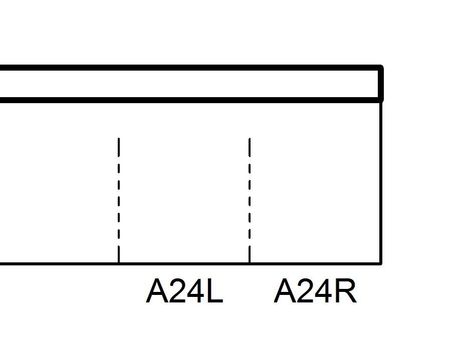

Why didn't you just add a flipper control to make this a left/right unit and do it all one way?
Tue, Aug 25, 2009 at 10:34:04 AM | Formula: Yes/No
Recit
Joined: Mon, Oct 30, 2006
25 Posts
flipping does not work because I have to label the cabinets on plan. see picture attached. If it is right hinged or left it gets labeled on the plan. Thanks.
Tue, Aug 25, 2009 at 11:53:04 AM | Formula: Yes/No
It can work ... not just automatic...
But here is your fix for what U want:
y/n instance Lock
y/n type Left
y/n instance Lockleft  = (and(Lock, Left))  << this controls your left locl
y/n instance Lockright  = (and(Lock, not(Left)))  << this contols your right lock

Tue, Aug 25, 2009 at 12:27:24 PM | Formula: Yes/No
Recit
25 Posts
WWHub, I think your suggested formula works well. I'm testing it now. Thanks.
