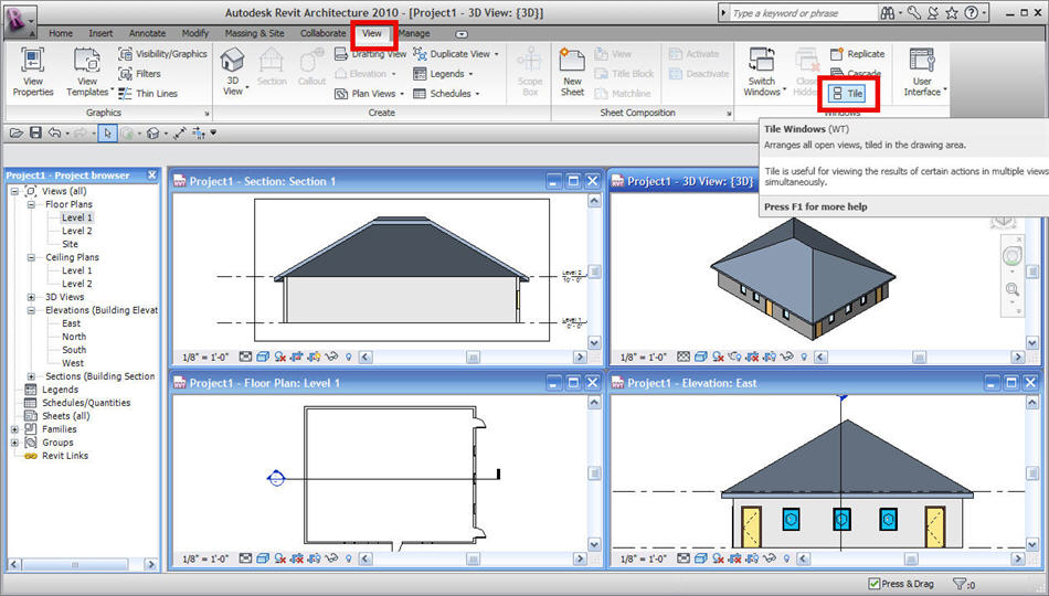

May you help me
How to take many viewports in revit?
Sat, Aug 22, 2009 at 1:26:44 PM | many viewports
Joined: Tue, May 22, 2007
5921 Posts
4 Stars: 205 Votes
Your question is unclear.... please, explains better what do you realy want....
Sat, Aug 22, 2009 at 10:24:11 PM | many viewports
dgcad
dgcad Avatar
Joined: Thu, Mar 17, 2005
1231 Posts
3.5 Stars: 36 Votes
I think you just need to 'tile' the windows as per the attached image. Or type from the keyboard 'wt' (window tile).
In 2009 you can use 'wt' or look under the 'windows' pulldown for 'tile', if I recall correctly

Sat, Aug 22, 2009 at 11:42:07 PM | many viewports
Hanh
Joined: Mon, Nov 17, 2008
16 Posts
Very great.
Thanks a lot
