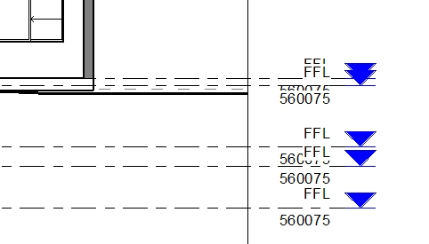

I am using Revit Arch 2009 to place a linked building module onto topography in multiple places. The strange thing is, I have repeat levels all labelled as 560075, but at different heights! How do I get the levels to display their actual height in the host file, rather than repeating the height of the building module from the linked file?

In each file the level marker has a property called 'Elevation Base'.  Set this ro 'Shared'.  Once you link the file, the linked file has a property that also needs to be set to shared.  This will reconcile them an set them to have the same levels.
