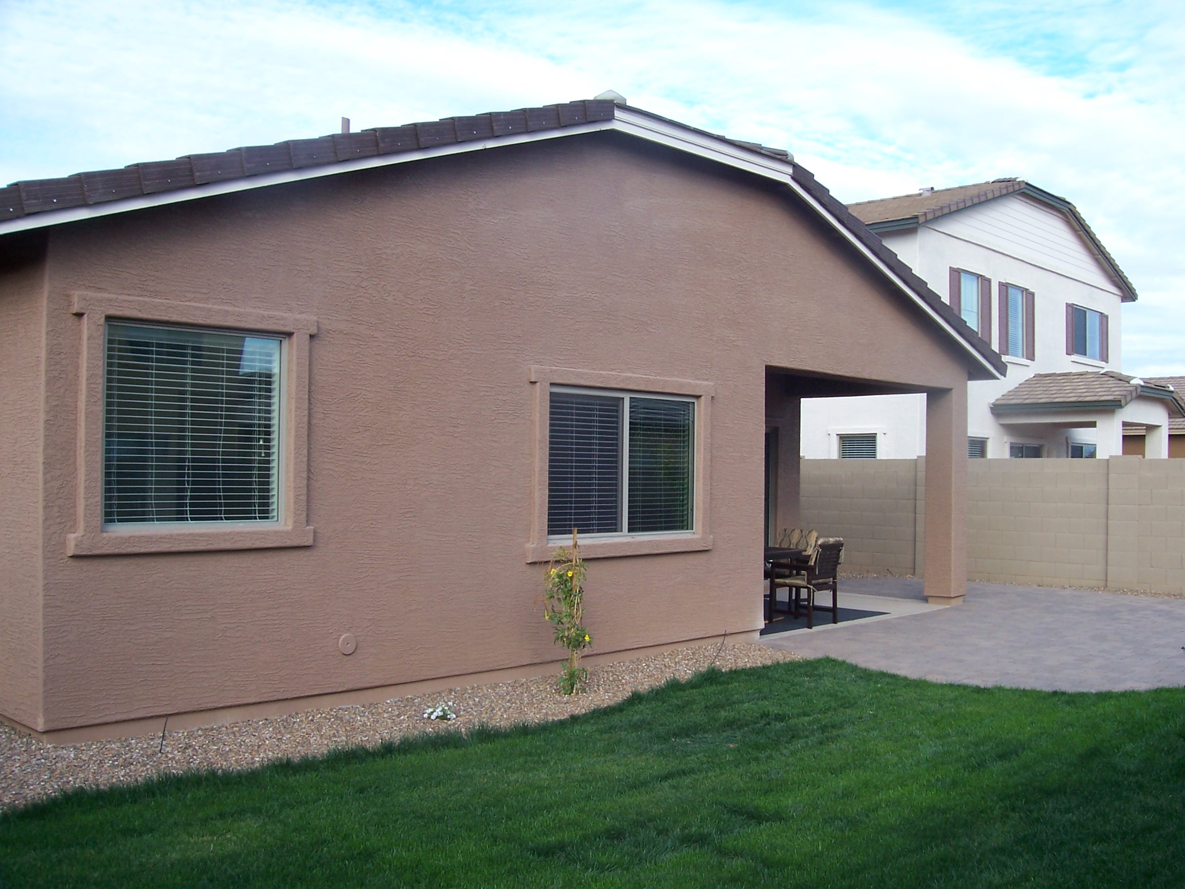

How can I extand the border on wall face  around the Door- window? Please check the attached JPEG. In this, you can see the elevation treatment around Windows. Please let me know how I can do it. I know, my words are not right but the picture will explain my question.
Thanks.
Fri, Aug 21, 2009 at 4:27:59 AM | Extended wall face around Door-Window
Joined: Tue, May 22, 2007
5921 Posts
4 Stars: 205 Votes
You have several options to do that but in the window/door of you want that "Cap", "Edit" the family(ies) and create that attached to that win/door with parameters if you want to control the tickness and so one, or you can create into a "Generic Model Wall Based" family or in a "Generic Model Face Based" fami.....  Or in a "generic Model" family and "nested" into the family of the Window.... there are several options you can use.....

Thanks Typhoon, It worked! I used "Generic Model wall based" Family.

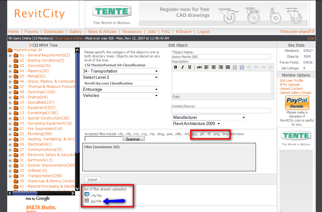

I want to post my this new created Family on "Downloads" of this Revitcity so that other people can use it. I uploaded as "Wall Projection/ Frame around Door & Window". But it doesn't show image of my family as icon. I uploaded 2 files and it shows online 2nd uploaded file. not first one.

You must create first a capture image of the object, then when you upload you must select that image and again select the object you want upload...

As you did the second time when you uploaded your object, edit it and just add the image, you can use the one I'm posting here...
