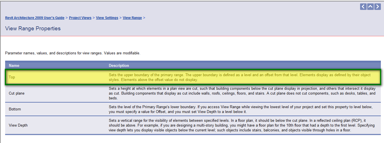

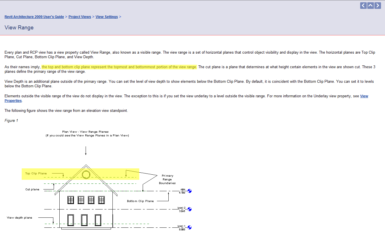

Can someone please explain what the purpose of having a top clip plane is?  I fully understand having a cut plane.  I also understand having a view depth plane to show elements below the bottom clip plane as a Beyond linestyle.  I don't get any different graphics when I change my top clip plane.  Can someone shed some light on a practical use for adjusting this plane?
Thanks in advance!

Taken from the HELP menu......
view range top clip plane
