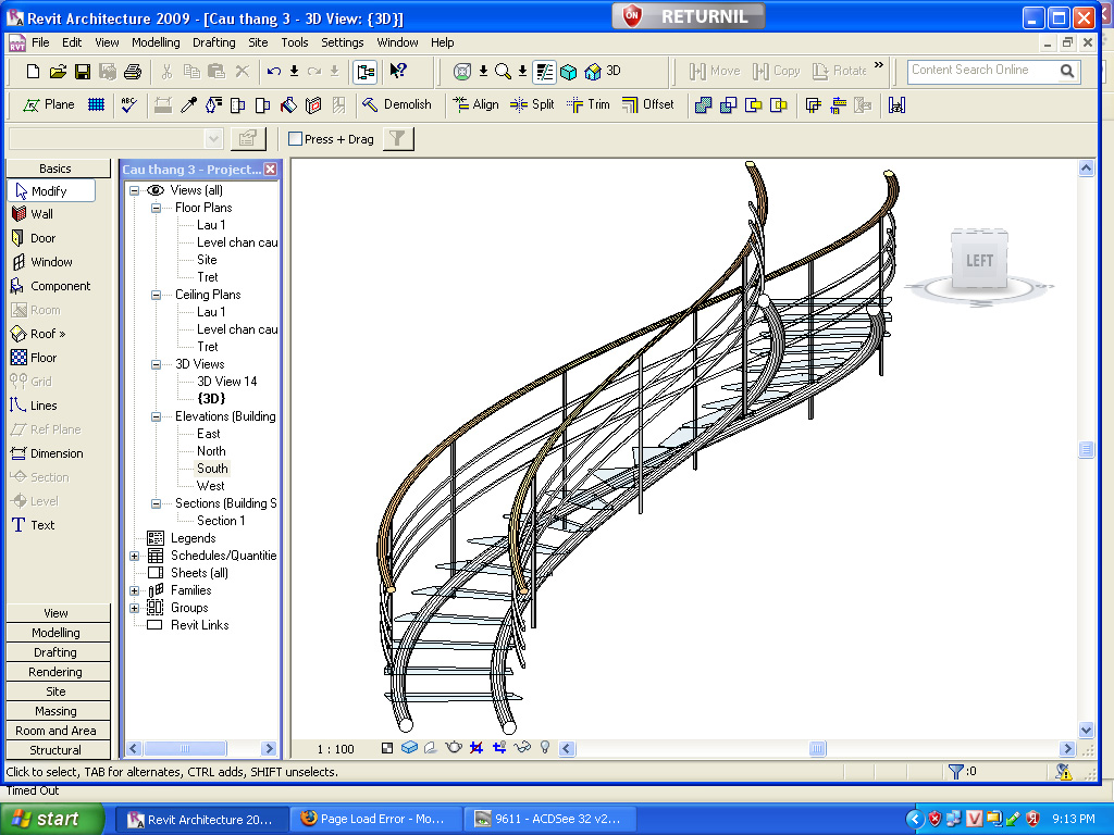

Hi everyone
May you help me.
I designed a stair that has two stringers, but I want these stringers are by a round shape and the runs by glass.
I don't know how to change the stringer from rectangle to round.
Thank you for any help

You can create that like a "Railing", draw that in the position you want, then in the properties you can change the offset, distance, the profile (in this case round), the material and so one...

Hi Typhoon
I followed what you showed me and created a stair like this (please look the picture)
Now I don't know how to add the support beams for the runs. Can you help me more
Thanks a lot

"Now I don't know how to add the support beams for the runs." - Like what? show me what you want....

There is the steel bars connect from two stringers to support the runs

Look at the "samples" in the on-line library.  There are sample stairs that have different configurations and stringers.  You can copy/clip those into your model and just change type.
