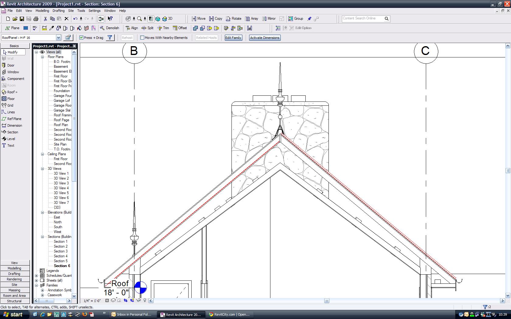

A tangential question about mirroring the standing seam roof. I've tried mirroring the SS roof along the ridge line of the roof Cryingor any kind of line for that matter), but for some reason it appears on a lower plane than the original. By that I mean that the mirrored SS roof shows up inside the actual structure of the roof rather than on the surface sheathing. Is mirroring an inclined object the cause of this?
See attached: the left is the mirrored SS, while the right is the original.
