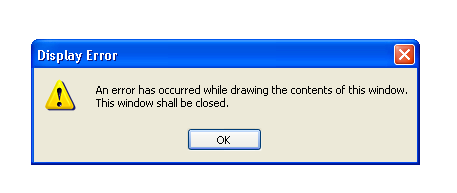

hi guys,
I keep getting a display error as shown on the attached image.
Its only ever when i go to a drawing sheet. and once it says it on one i cannot open any of my other views without closing the drawing and reopening it.  very frustrating.  i feel like it is probably the titlesheet ive created causing it but dont know what i can do to fix it.?  Cheers
Edited on: Wed, Aug 12, 2009 at 3:13:20 AM
Wed, Aug 12, 2009 at 7:13:03 AM | Display Error -
I have seen similar problems when a view or family is corrupted.  If it is a titlesheet then you are lucky.  Try creating a new titlesheet in a seperate file.  If it works, load it in your file as the same name as the corrupt one and see if that works.
