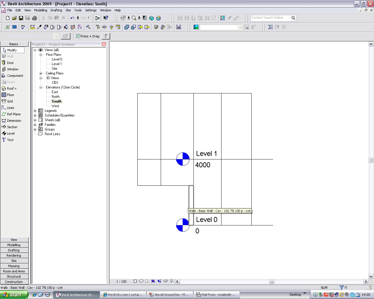

 Every time I create a sketch line for  curtain wall adjacent to wall face it automatically snaps the line to the middle of the wall when I finish the sketch. Is there a way to stop this happening as it's causing some real headaches. I can't seem to move the sketch line back to where I want it without it snapping again when I finish the sketch. I've tried turning allow joins off for both sides of the curtain wall but still no joy.

I have created a curtain wall (and turned off wall joins). I am now editing the profile in elevation so that it forms an upside down L shape wrapping over the top of a lower brick wall (which is seen in section when I edit the profile of the curtain wall and runs through the middle of the the curtain wall). The sketch lines I am referring to are the lines creted for the profile when in the 'edit profile' mode.
When I place one of these lines vertically on the face of the lower brick wall it gets moved across to the centreline of the wall, changing the sketch for the profile so that it no runs up within the wall instead of on the face of it.
If I get time I'l ltry and post a couple of screenshots to show what I mean

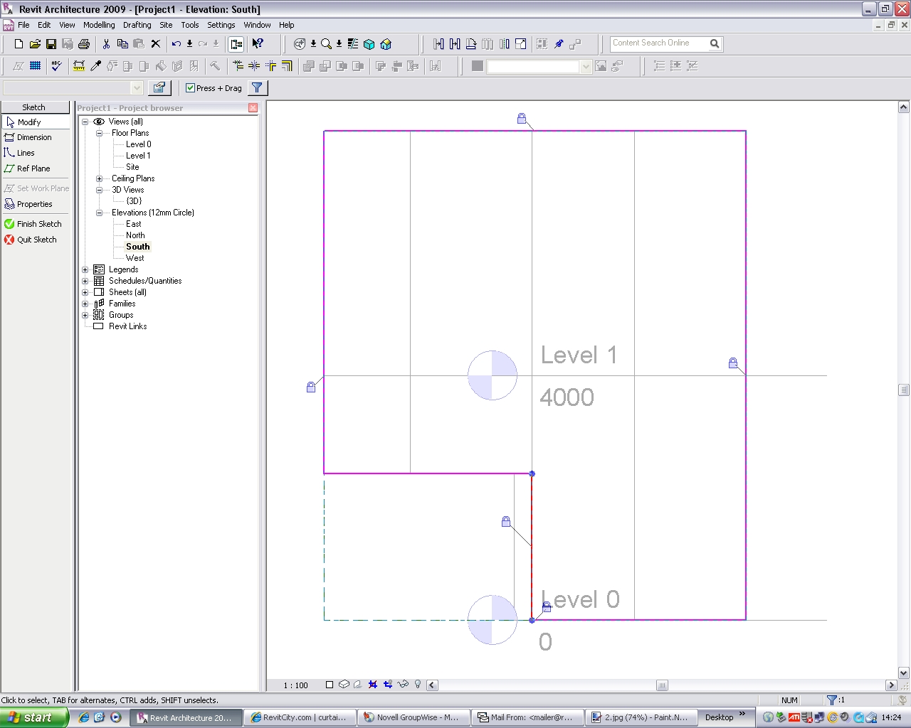

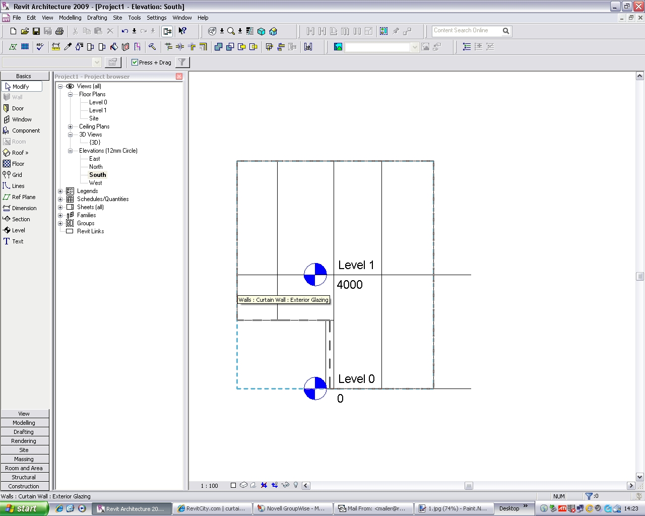

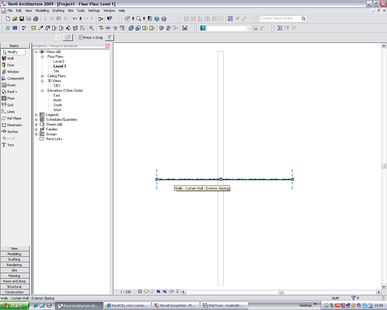

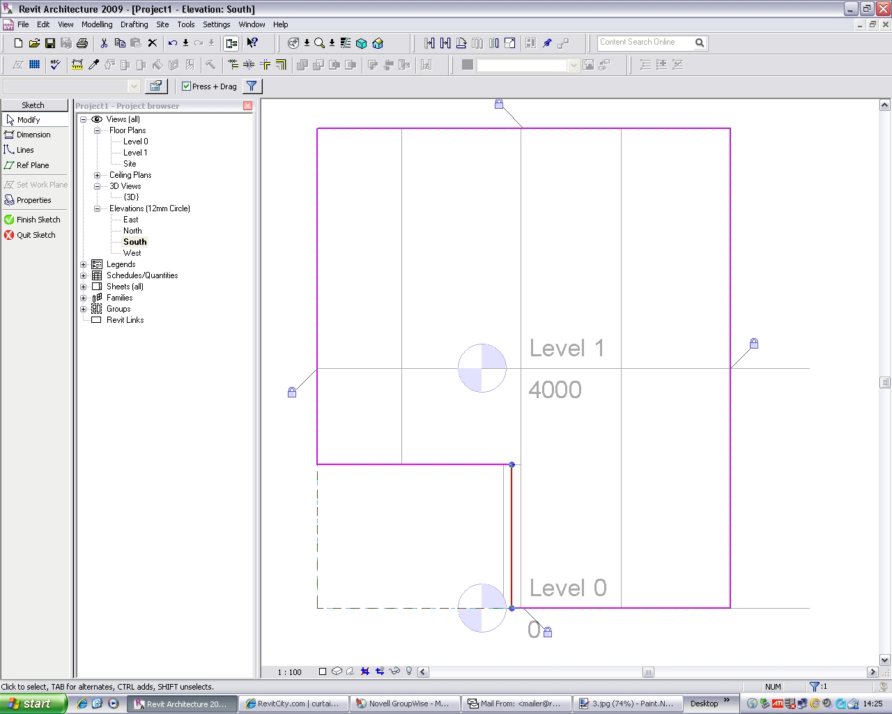

Ok, I've managed to make some screenshots of the problem.
Image 1 shows the wall highlighted which runs perpendicular to my curtain wall.
Image 2 shows the curtain wall highlighted
Image 3 shows the sketch profile I am trying to create for the curtain wall in elevation
Image 4 shows the sketch after clicking finish and going back in to it, notice the highlighted line has automatically moved to the centreline of the wall, no matter what I do I cannot get this line to stay on the face of the wall, it always moves back o the cl of the wall, even if I lock it to the face.
Image 5 shows the curtain wall and wall in plan (curtain wall is highlighted)
Wed, Aug 12, 2009 at 8:48:48 AM | curtain wall sketch snapping problem
I think th only fix is to split this into two curtain walls and not use an end mullion on the overshooting wall where it joins the full height portion.
Wed, Aug 12, 2009 at 8:54:07 AM | curtain wall sketch snapping problem
#9
RevitRainman
Joined: Thu, Jun 11, 2009
10 Posts
Unfortunately that was the conclusion I came to befoer I thought I'd try here to see if anyone could help.
Also unfortunately, splitting the curtain wall works on this simple example, but doesn't work when you start trying to do anything more complex.
Does anyone know if this is fixed in 2010?
