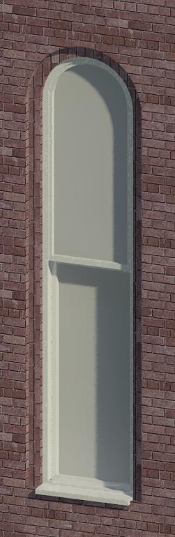

around this window is a generic wall based model wich is a void extrusion. the wall it is based off of has no cut pattern. why do you think that the bick that is cut goes the oposite direction?

If you rotate the fill pattern on the inset bit it should render correctly.
