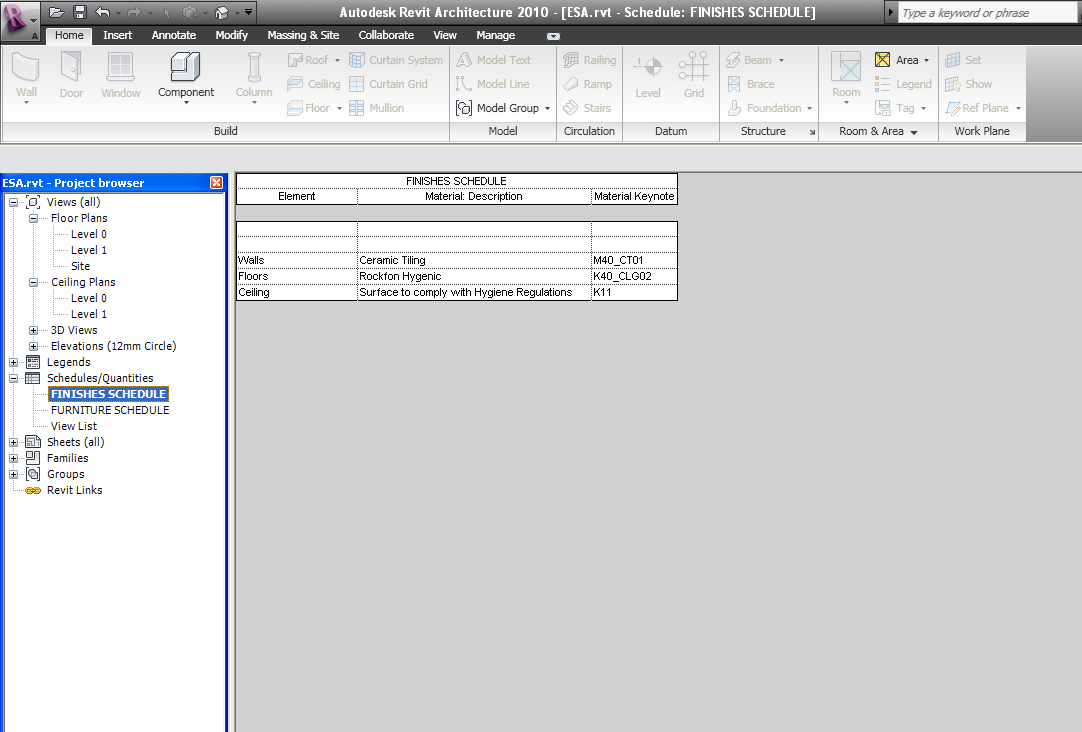

Hi,
I want to create a finish schedule (Wall finish, floor finish & ceiling finish).
I can create individual schedule but is there any way to combine them and get all finishes in one schedule.
thnx in advance
Now on the implementation stage....
Mon, Aug 10, 2009 at 6:25:50 AM | Finish Schedule
Rams
Joined: Fri, Mar 28, 2008
128 Posts
3 Stars: 3 Votes
I figured it out.
Creater Material take off , add required parameters and then sorting..
