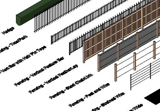

Why don't you look at the sample projects in the on-line library?  There are fences there like you want.  See attached.

There is Sample Files folder which is part of Revit Software. Inside that folder you'll see rvt. files such as fencing, railing, roofs, stairs...simly open fencing file and copy any  fence type you want to use and paste in your drawing, after that just use match type and replace your fence with one from Sample Files folder. Just to repeat they are rvt. files not rfa files, still handy though.

Are you sure that there is no material parameter?  If you open the relevant balusters under railings in families in the browser there is a parameter for them there.  The materials for the rails are set in the railing element properties under the rails.

The on-line library is here: http://revit.autodesk.com/library/html/index.html
The fences are under the Revit instruction and Help samples.
If you are not on 2010 their are archived libraries for earlier issues.
