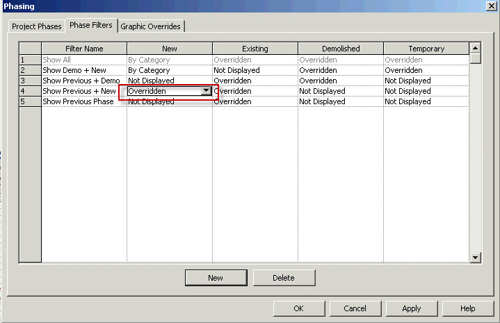

I am trying to make my new walls show up with a solid gray hatch.  So under settings>phases>new construction>graphic overrides, I set the cut hatch pattern to be solid and gray.  However, when I set my view to show existing + new, the walls don't change their display configuration at all.  I can go in and override each wall separately, but the phase override does not seem to work.  Am I doing something wrong?  Missing a step?  Thanks in advance to anyone that can help!!

To get the graphic override to show in your view, you need to modify the "phase filter" Show Previous plus New to show new construction as "overridden".  Probably best though to create a new phase filter with a new name to do this so the OTB filter is left in its original condition.
See the attached image and give it a try.

I had a feeling I was missing something really easy...thanks so much!!
