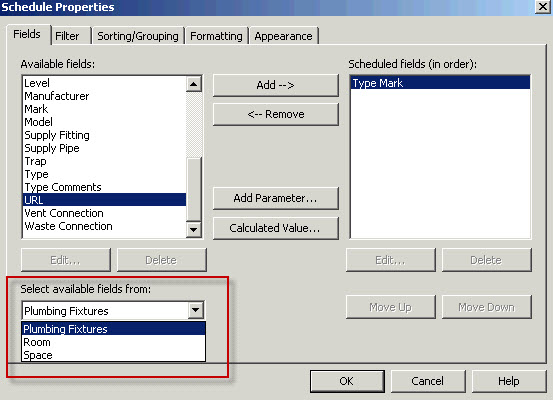

Certain categories in Revit are "room aware" such as" Furniture, Specialty Equip and Plumbing fixtures.
The trick is that when you schedule these objects to pay attention to the lower left corner of the "Fields" tab in the schedule dialog.  Here you can choose to add Room and Space related fields to your schedule.
See attached image.
HTH
Tom
