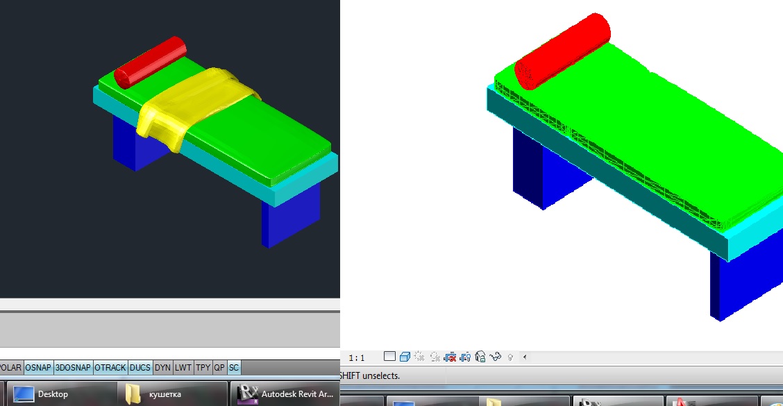

Why when i import in revit, this model from autocad, the mantle is missing?
Dwg to RFA and Materials.
