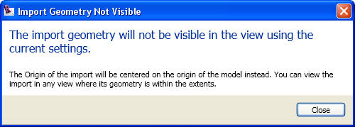

I get a pop-up error message tilted "Import Geometry Not Visible" when trying to link a dwg file into a RS2010 project.  I have never seen it before, and have no idea what to do with it.  The linked file does not show up at all in revit.  I have tried exploding and flattening everything in the dwg file, and still nothing.  Now it seems I can’t link in any dwg file into this model.  Does anyone have any idea what this means?

Here is the error message.

I have never had any problems linking in DWG files before.  This only started this morming when I tried to link in an ABS ductwork file to show roof top equipment.  But the file was not even drawn in 3D, other than some 3D wall styles.  I even flattened the file and exploded everything, and still nothing.

Never mind.  Stupid OE problem apparently.  I just went into the visibility graphics, imported categories screen, and found that somehow “show imported categories” button was unchecked.  Doh!

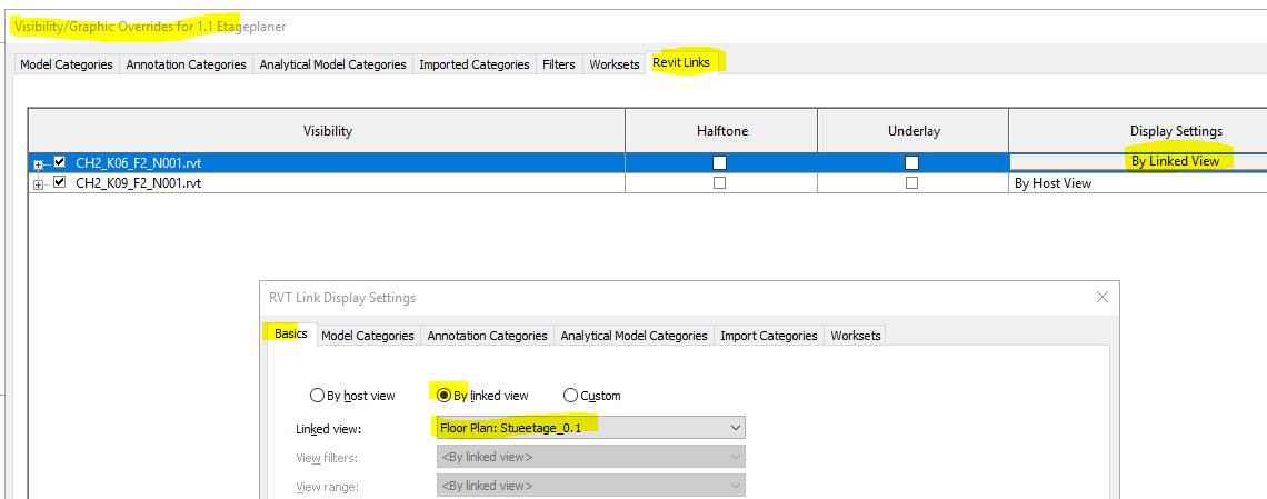

So I'll share this, hoping it helps sby else too. I have a central RVT file (A), which I work on from a local file (nothing new here). Then I have another central RVT file (B), which I again work on from a local file (nothing new again). My setup is that file B is linked inside file A. B only contains our modular grid, nothing else. All of a sudden file B stopped showing in file A and when I try to relink it it gives the annoying "Import Geometry Not Visible" prompt. Tried checking everything and looked for the visibility of grids, view range, etc. etc. ... everything from many similar threads. I finally discovered that it had to do with the settings inside our 1. VIEW TEMPLATE (you might not have one so just skip to next step), then 2. V/G OVERRIDES, 3. Revit Links, 4. last tab DISPLAY SETTINGS. Open that and play with it. In my case I had to look under the 1st tab 'Basics' and then toggled the radio button to 'By linked view' and then for the row 'Linked view' and then there I selected the correct floor plan view which hosts our grids. Play with that and I hope this tip helps. Best of luck!
