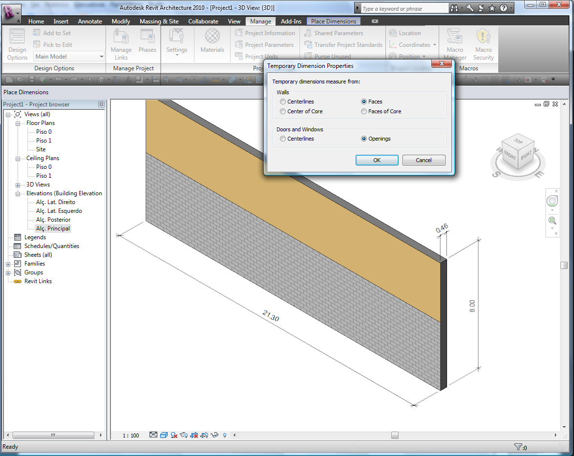

I don't know what are you doing wrong, in Manage>Settings>temporary dimensions select "faces" then if you need (and you do) select the work plane you want and dimension...

 I did change the temporary dimension settings like you showed.But still not seeing the highlights on wall faces.
