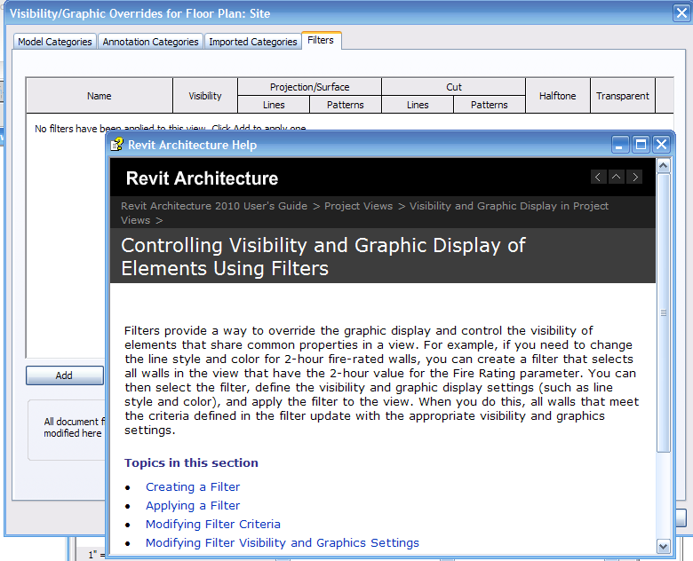

Even better, save / use / re-use View Visibility Grraphic Filters so you can filter (with even more precision) a vew with the click of a mouse. See attached image.

Quoting dgcad from 2009-07-26 09:02:29
"Even better, save / use / re-use View Visibility Grraphic Filters ..."
Different filter type, but still a good tool to know.
