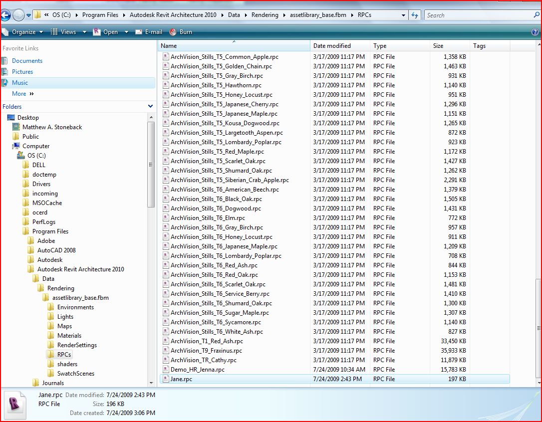

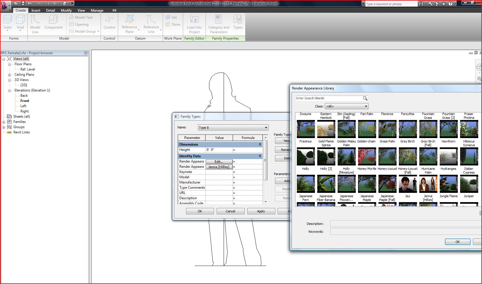

I tried adding the custom rpc I made through the free RPC Creator, but it won't show up in the assest library when I edit the standard RPC female family.  I copied the newly made .rpc into the folder with the rest of them.  What do I need to do to be able to use the person I made?

Change the name, must start like the others "Archvision_Jane", then restart revit and it's done.
