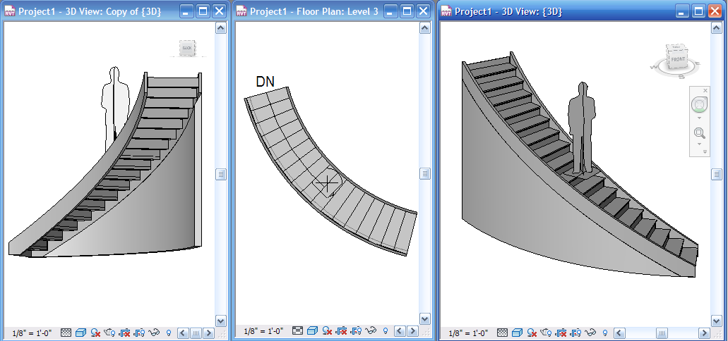

I was able to do this very quickly by extruding a 'roof', attaching the wall top to the roof and then turning off the roof element in the view.
For the stair, in an elevation view I picked the underside of the stringer as the linework for the extruded roof and made the roof .01" thick.
Seems to work.
