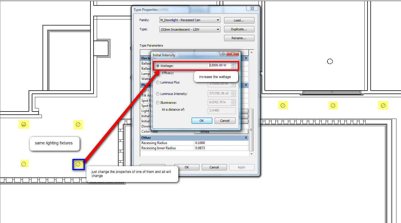

When you pick in one light and change the properties, if they are in the SAME FAMILY of the others, when you change one you change ALL of them, if you have "Inserted" 2 or 3 families in the project, you only must to change 2 or 3 lights in the properties.... see in the HELP menu what is FAMILIES and how it works...

See the image attached to understand what Typhoon is telling you, then you could get somethig like this: http://www.revitcity.com/gallery.php?action=view&gallery_id=9775
