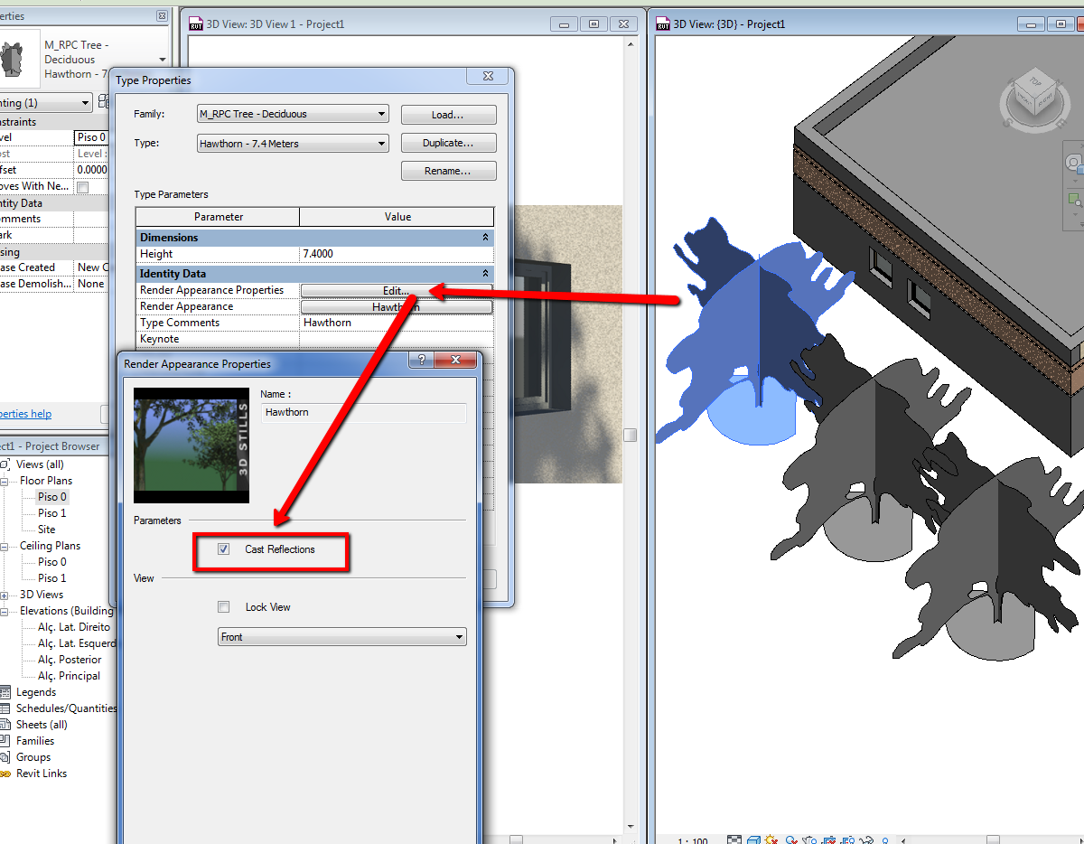

Tue, Apr 19, 2011 at 12:45:32 PM | Tree reflections
Joined: Tue, May 22, 2007
5921 Posts
4 Stars: 205 Votes
I don't know in MEP but did you try to turn ON "Cast Reflection"?

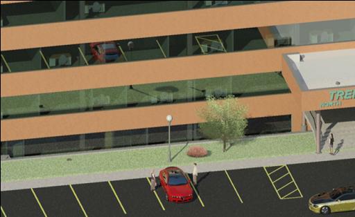

Tue, Apr 19, 2011 at 1:55:11 PM | Tree reflections
vinnygolfer
Joined: Wed, Jul 8, 2009
181 Posts
4.5 Stars: 4 Votes
as you can see i'm still having no luck with it. the bush and tree cast a shadow in the reflection but not the mass. and the people didn't even show up as shadows next to the car.

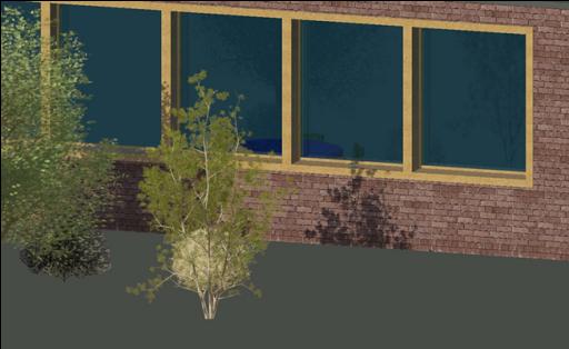

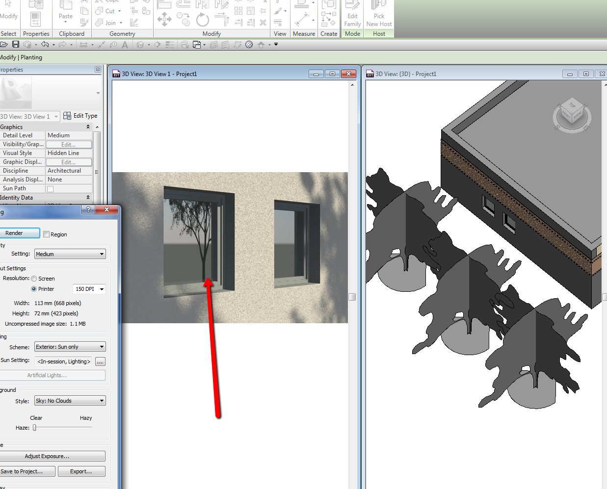

Wed, Apr 20, 2011 at 9:24:33 AM | Tree reflections
vinnygolfer
181 Posts
4.5 Stars: 4 Votes
Just to update. i tried it again with the direction that Typhoon gave, and with a little tweeking i now have it working. as you can see the table is showing inside as well as the shadows and reflections of both trees, and both bushes. i had to play with the amount of reflectance the glass has to show both objects inside and outside the wall. but now i'm confident that i can make it work for any situation down the line. thank you for your input Typhoon. ;-}
