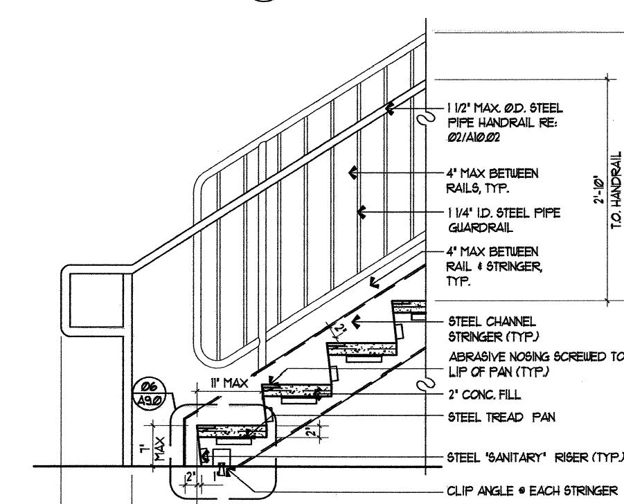

Based on the diameter of the rod and Weight of the steel.
I want to calculate the quantity of steel required for railing and baluster for the following given attatchment ( Detail railing.jpg) from the revit Quantities. Is it possible. Please let me know.
