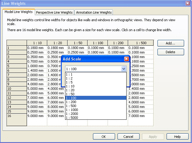

I want to create a standard line weight with the Line Weights dialog. However, there doesn't seem to be an option to create a custom scale. All they have are preset scales that you can create. For example, I have 1:25 views, but the Line Weights dialog for Model Line Weights only have 1:20 and then 1:50.
I was wondering if there was a work around that anyone came up with.

I saw this post , it is from one of our revit city experts
http://plevit1.blogspot.ae/2014/03/line-weights-for-custom-scale.html
