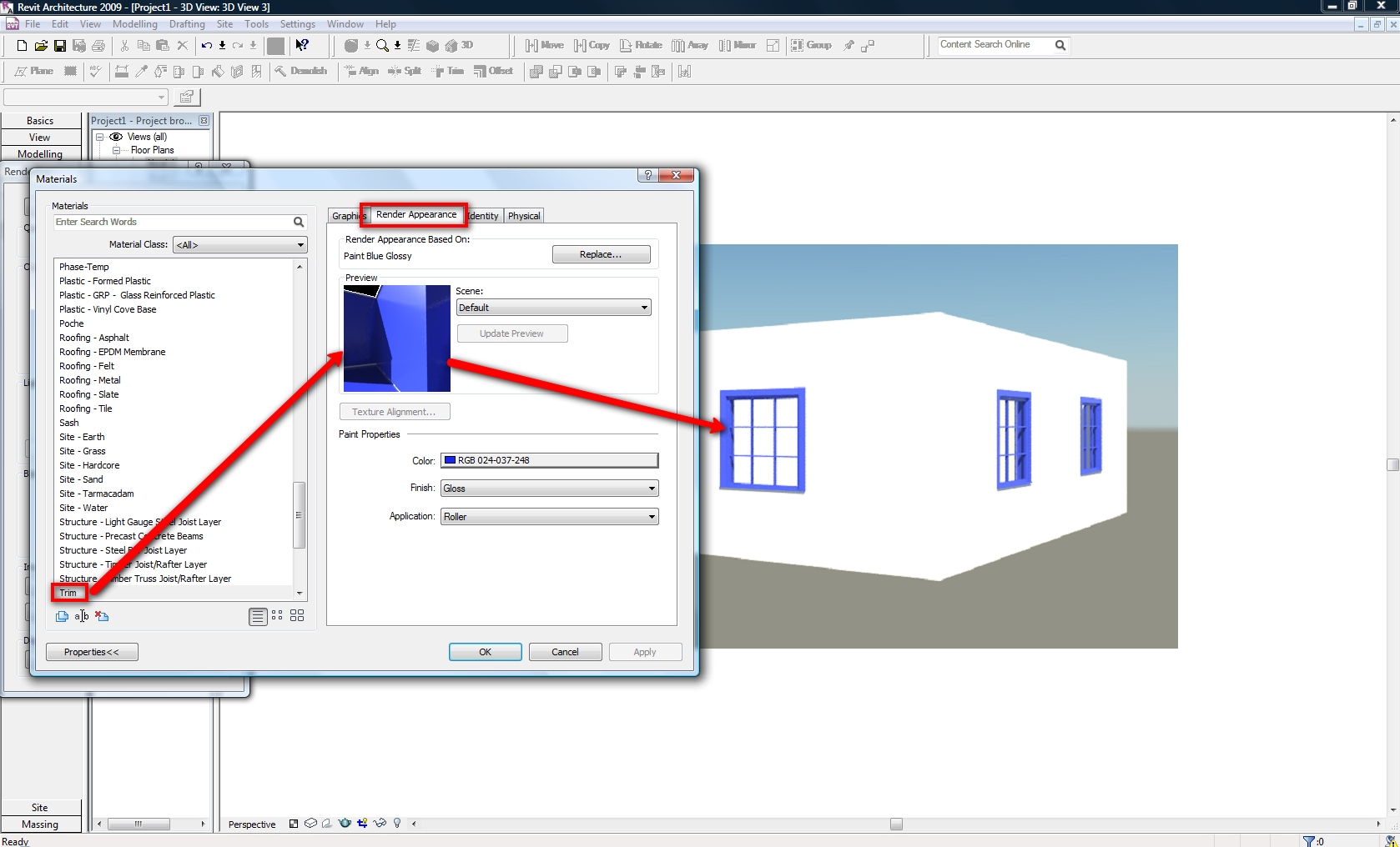

In my project model, I made some changes to the colours of my windows and door frames by changing the colour from white frames to blue frames. All is fine when I look at my model before rendering, but after I render my project, the frame colours on my windows and door go back to their default colour of white.
How can I make sure the colours stay to the colour I have changed them to?

Did you check in the properties of your doors and windows the "Render Material" you have there???

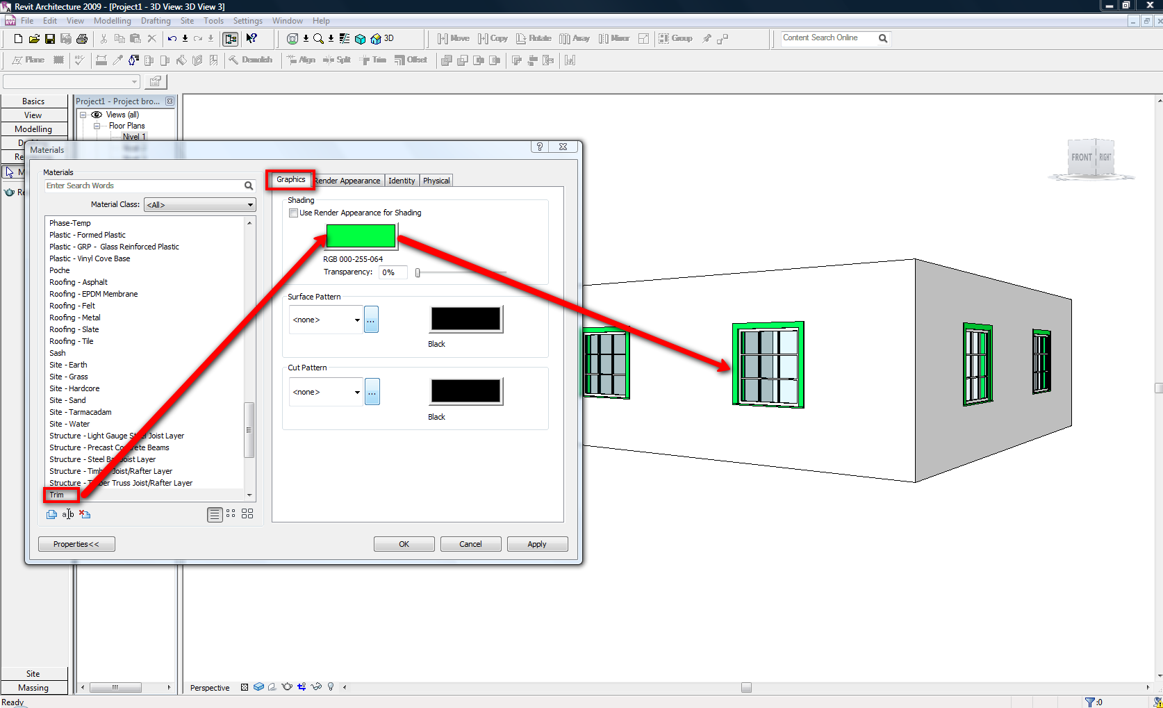

"All is fine when I look at my model before rendering"....So you're looking your model in Shading w /edges mode?. Well, make sure you are changing their materials (Render Appearance) not their shading colors....

Thanks guys!
It's so easy to overlook things. All appears fine after checking rendering appearances.
