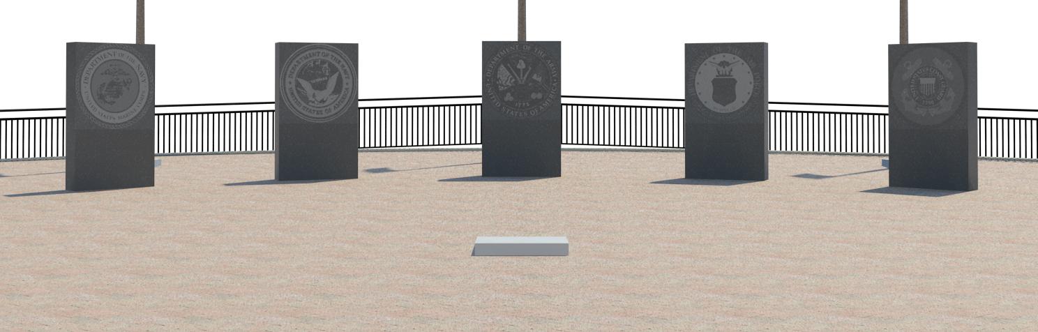

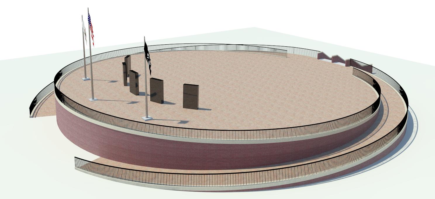

So, I have a walkthrough set up in Revit 2009. I did a test render of the video, 100 frames, at draft quality. It took about 45 minutes (it's a really simple project). I would like to do a high quality rendered fly-around, walk-around. I've seen all the posts about rendering in 3DS Max. I suppose my real simple question is, how? I'm assuming I export from Revit in a FBX format. I'm waiting on a copy of Max, I haven't tried it yet. When I export, does it take with it the camera views, angles, and speeds? I do know it takes the materials, but what about decals and custom materials I've assigned?
I have a brand new, powerful computer. Intel i7 920 2.67Ghz processor, 12GB RAM, and a video card with 1726MB memory. I could just set it up and run it overnight, but I'm curious about Max for future, more intensive projects.
Attached is an aerial view of what I'm trying to render, and the decals that I'm concerned about.

yes, FBX will be the format you need, it will take your revit materials across but will only take one camera with the model.
Max uses a different method to create a fly through, you'll need to figure that one out Smile
but the render will look much better and will take less time as well!
