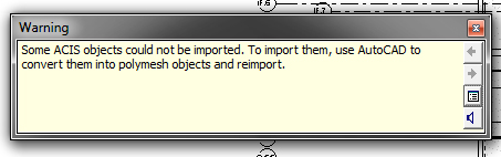

I get an Warning when trying to import a 3D AutoCAD file into Revit as follows -
"Warning:
Some ACIS Objects could not be imported. To import them, use AutoCAD to convert them to Polymesh Objects and then reimport."
Question -  What command do I use in AutoCAD to convert the ACIS Objects (3D Solid) to Polymesh Objects so they will import and display in a Revit Model?

I'm getting the same error as SD Binc.
I loaded this lisp but it is Poly mesh to 3D Solid only. Do you have one that will changes a 3D solid to Poly Mesh?
Thanks

warning attached
