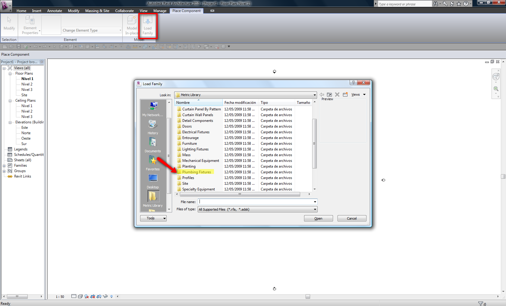

Hi, I am using 2010, I do not seem to have anywhere near as many family instances as I should have. For example when i go to Place Components I have the option of: - 2 trees - 1 desk - quite a few RPC trees - Car Parks How do I get stuff like toilets, sinks etc? Also all the names end in (AUS) is this because it is all the australian version has or how can I get more of these instances? cheers

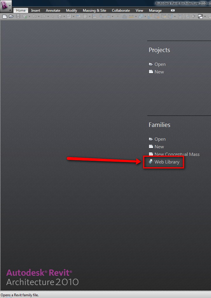

I think you are new to Revit, right?, so after you've picked Place Component, pick the Load Family Icon, you will find there all the components you want, if you want to get more, in the Recent Files screen, you will find Web Library, just click on it...
