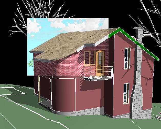

can you give me an idea to create rounded roof fascia and gutter?

You can put new refernce plane for sweep in roof plane from elevation ...

You should be able to get it to work using an in-place family and selecting the roof as the work plane and then picking the edge for the sketched path. Then simply select the profile. NOTE: You cannot have a profile with non straight lines and a path that contains splines or ellipses, so it would need to be a simple curve.
