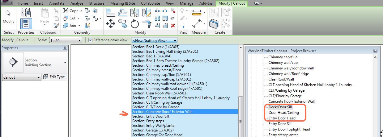

Help! I have the same problem.
I have a few similar sections, and have callouts: A1 A2, referencing one of them: A, and on another: C, I have placed callouts that reference these, but on the third: B, those callouts: A1, A2, do not appear on the dropdown list when Reference other view is selected.
Any suggestions?

I cannot find why some views are missing from the dropdown list.
See screen capture.
At least 3 section views are missing. 2 of which I want to have as similar reference callouts.

Thanks for the response.
Yes, I can see that might be an issue for some situations, but all the views I am interested in creating references within and to are Sectional. Some Sectional views are not showing up in the list.  My screen capture doesn't show the complete list, but all those views visible in the Project Browser list on the right are Sections, and the dropdown list on the left does not include those circled ones.
Any other suggestions as to where the problem may be?

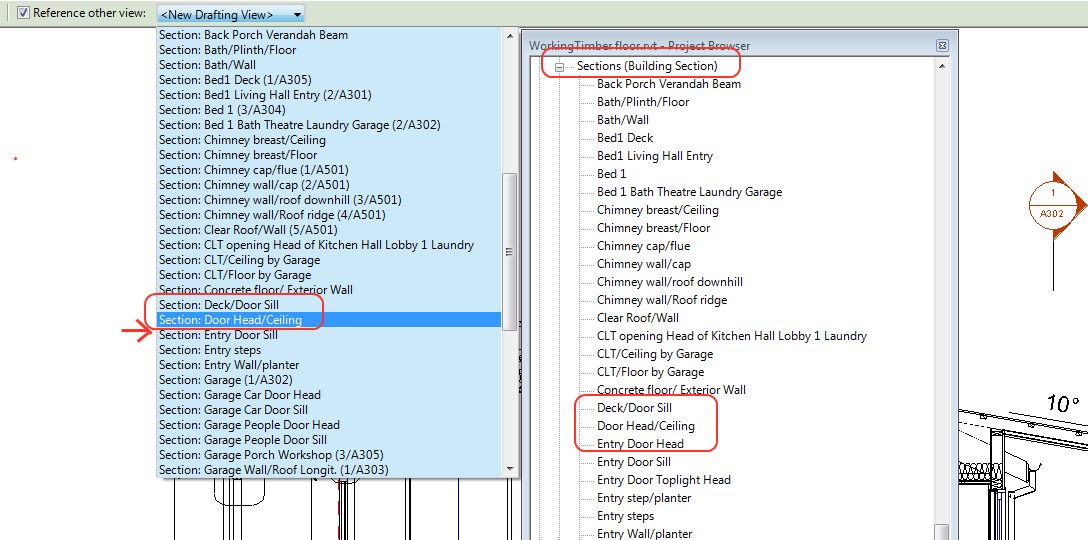

Hi,
Thanks again for the response.
Here is another screen capture showing the "Section" folder, so you can see they are Section views.
The odd thing here is that  now only one of the three Sections that were missing previously is missing: "Entry Door Head".
The views that have reappeared in the Reference Dropdown list are: "Deck/Door Sill" and "Door Head Ceiling". In the previous screen capture they were in the Project Browser list, but not in the Reference dropdown.
I am trying to create these reference callouts in the same sectional view as before. That has not changed.
There should be no problem referencing any of these views in a section as the original is in a section, and there are already are referenced callouts to them in another section as well.
