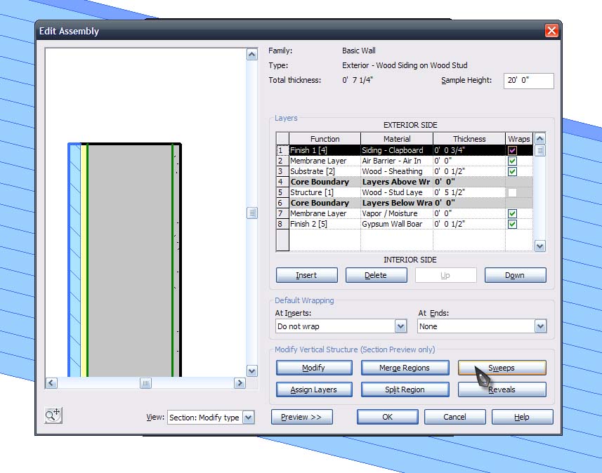

if you start with pre-drawn profiles, these things move alot faster.  for wall sweeps, make the sweep part of your wall type:

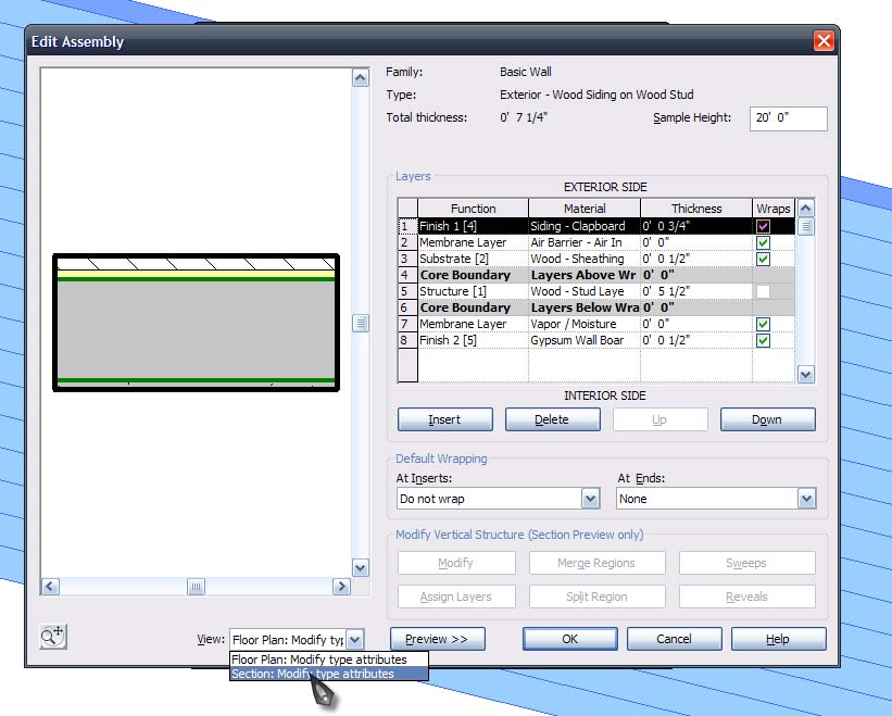

First: open your wall type properties, select edit structure and change your preview from floor plan to section view
Second: click the sweeps button

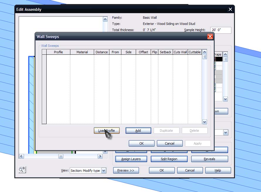

Third: load and select a profile - there are predefined profiles or you should make your own in advance

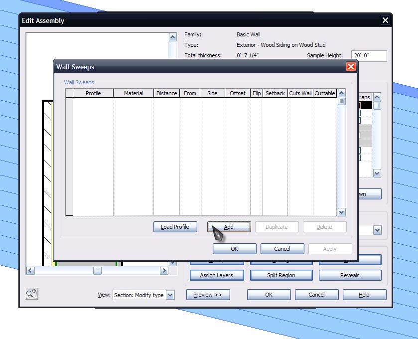

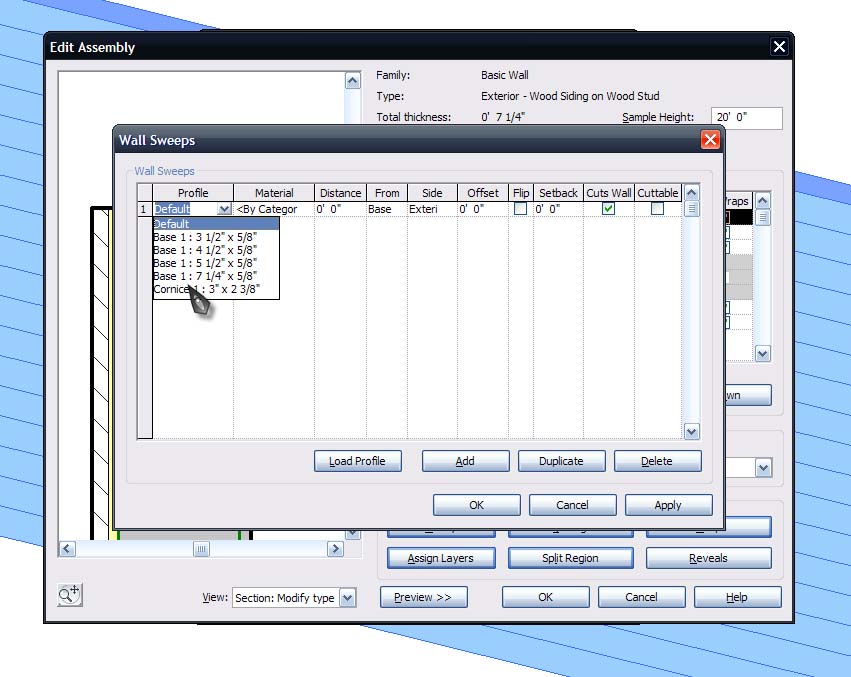

Fourth: click add profile, select the appropriate settings and click apply; adjust your dimesions as required.
now that wall type will always have a cornice, or basemoulding, or chair rail... whatever you choose.
