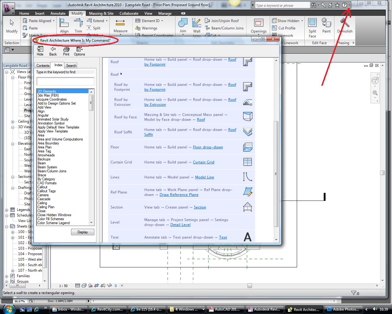

 BTW this is a useful web-based aid to figure out where the commands where moved to in 2010:
http://www.nichitecture.com/downloads/Where%20is%20my%20command%20in%20Revit%20Architecture%202010.html

Ther's also a 'Where is my command' help item in the drop down menu next to the help button in Revit.  Not as pretty, but it shows where all the previous commands can be found.
