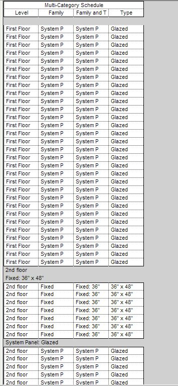

Sat, Dec 11, 2010 at 10:37:17 PM | Select By Level
MaxModeler
MaxModeler Avatar
Joined: Thu, Nov 25, 2010
21 Posts
2 Stars: 2 Votes
Sagar, Ive made a schedule with a level field. How do you select your objects from the schedule to hide or unhide? Noob.

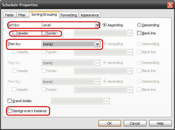

Mon, Dec 13, 2010 at 8:40:56 AM | Select By Level
sagarkagathara
sagarkagathara Avatar
Joined: Sat, Jul 5, 2008
30 Posts
Max,
Looks like you have 'Itemized every instance' in schedule property.
See attached image. It shows how you should sort the schedule. Once you format it that way, you'll get only 1 row per level. You can then easily click on the rows one-by-one to select elements by level.
Feel free to ask further, glad to help.
