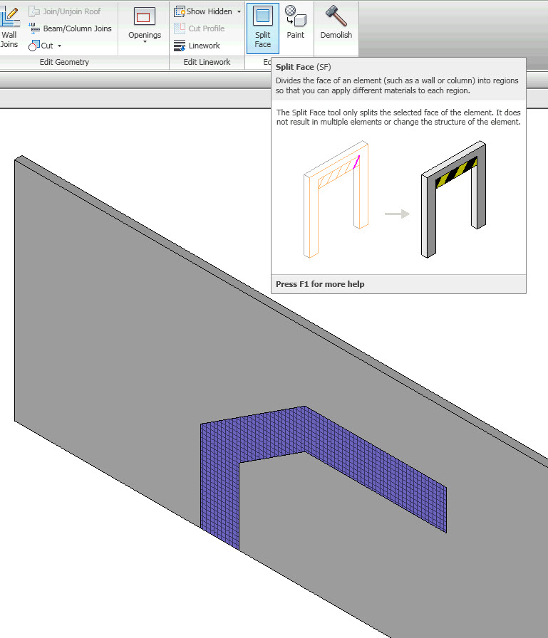

Could you use the "paint" toll for this?

You can split the face of a wall, define a new surface are and then "paint" a material onto the wall suface and any split face of the wall.  This works for other object types as well.  Just be careful though not to violate basic BIM principles and choose to paint only things with a nominal thickness to them.  Brick for instance is probably best modeled into a wall type rather than simply painted onto a surface.
HTH
Tom
