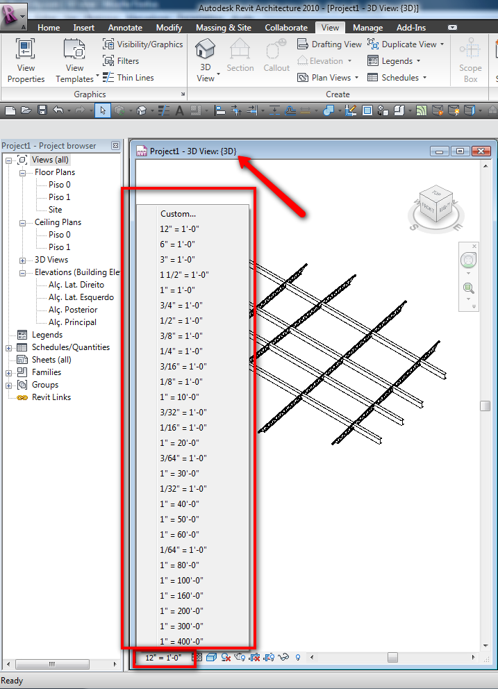

Are you talking about this???

Sorry I guess I wasen't all that clear. I am talking about a camera view, when I place the view on paper it is at 1/8" : 1'0" and I can't see anywhere to resize the scale. When I pick View 3D view Camera it defalts to 1/8" scale even if I change the scale by unchecking perspective, change the scale, and recheck perspective the scale remains the same. I wan't the drawing on the sheet to show at 1/2" 1'0"

No perspective is scalable because the scale changes with the depth and that is what a camera view is.

I was able to get the desired results by exporting the perspective view as an image and importing it into a drafting view. I was then able to change the scale.
