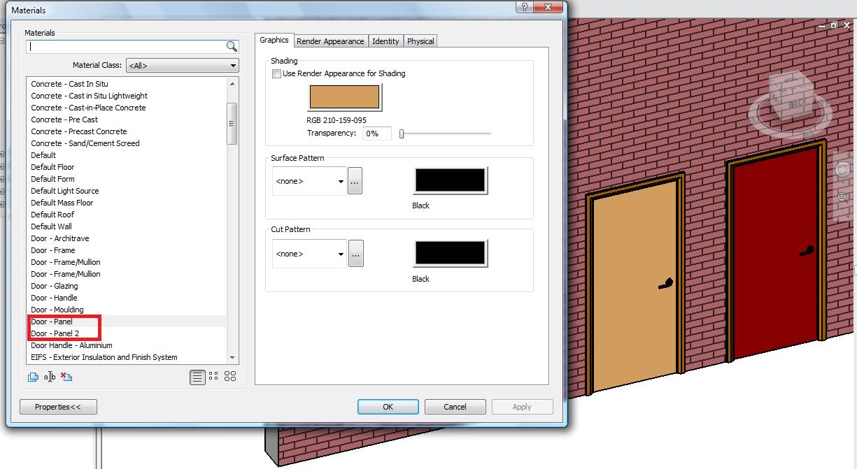

The colour is part of the material you have given the door in the family. Create a material (in the family) with a unique name that doen't exist in your project. Them you will then have control over the material/colour.

You can just give it a new material.  Typically doors have a material called 'Door -  Panel' which affects all doors.  Duplicate this material and apply it to the garage door.

If you could go to the door family select the door material parameter and change it from a type to an instance. then reload it into your project this should allow you to change the door material on individual doors.
