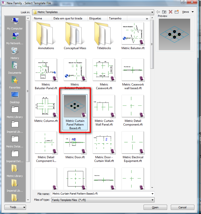

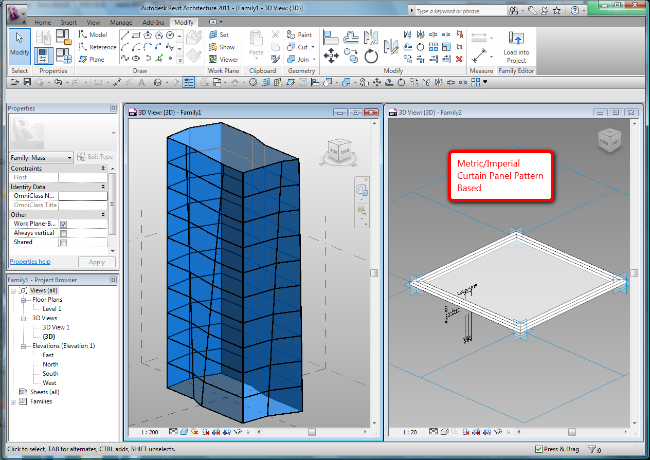

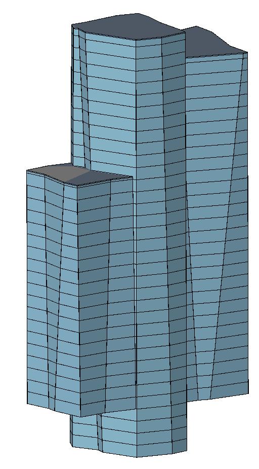

Tom is right, ONLY in 2011 you have the new Adaptive Component wich is awesome BUT also in 2010 you have the new Conceptual Mass where you can create the the shape of mass you want, divide the surface like you want, then create the panel in the "Metric/Imperial Curtain Panel Pattern Based" and apply to the surfaces like you can see in the images below...
