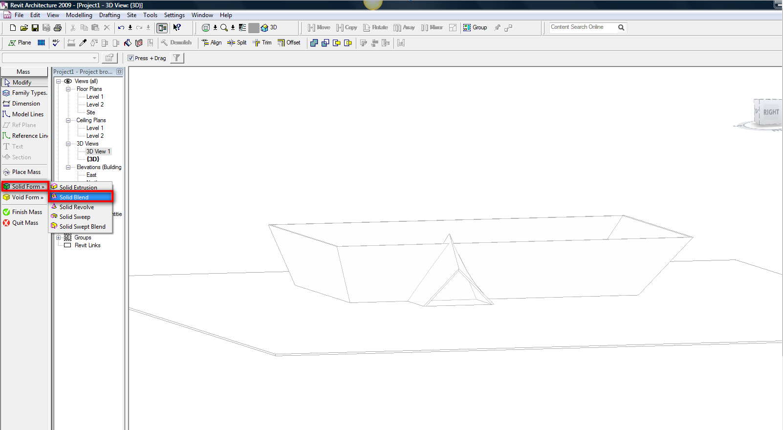

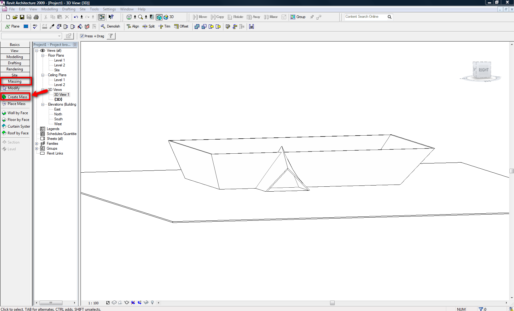

You don't specify what version you have, but assuming it's 2009, one way you can do that is with a mass (Solid Blend). Go to your Design Bar--> Massing--> Create Mass-->Solid Form-->Solid Blend. Once you have created your mass just pick the side(s) of it with Wall by face tool to create you walls....

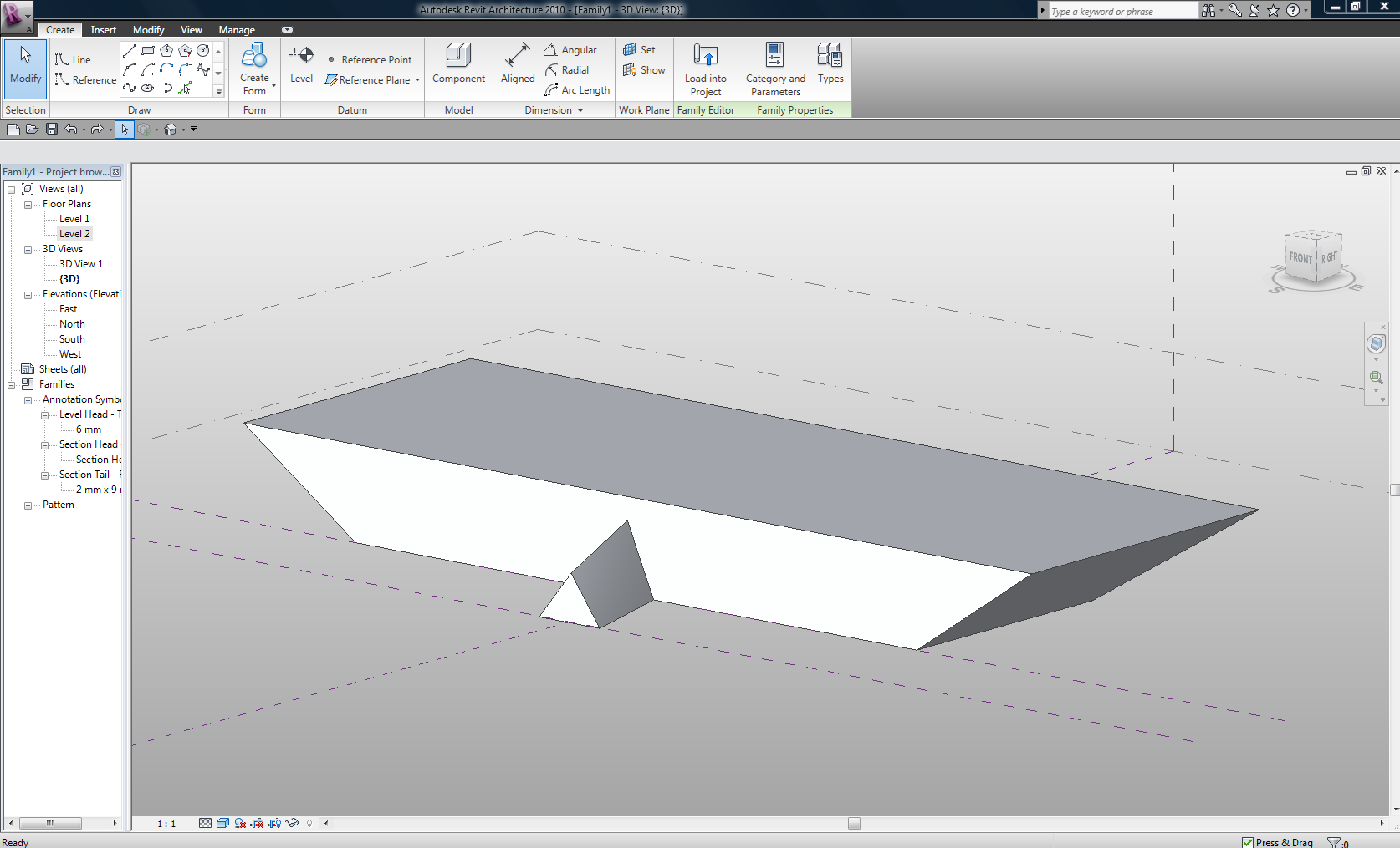

So then, you can try with Conceptual Masses, load into Project and apply Wall by face....

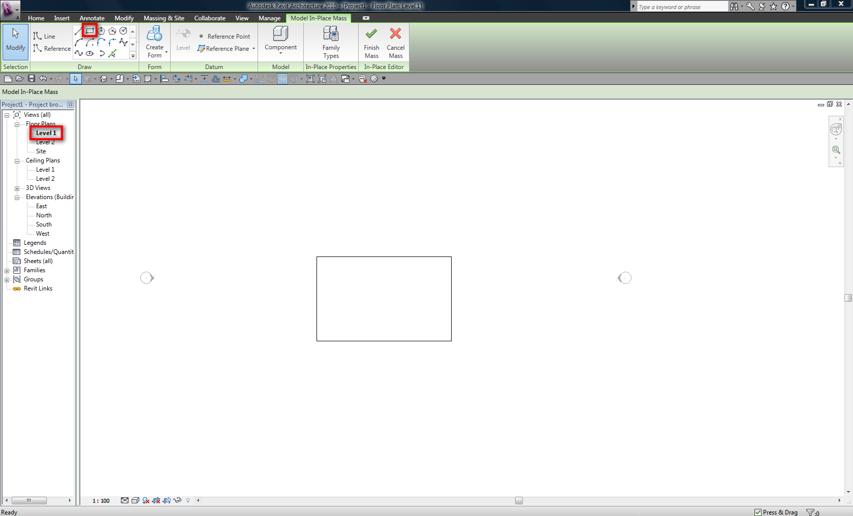

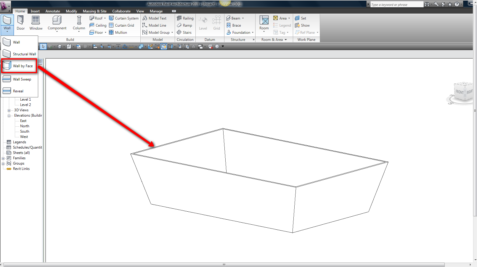

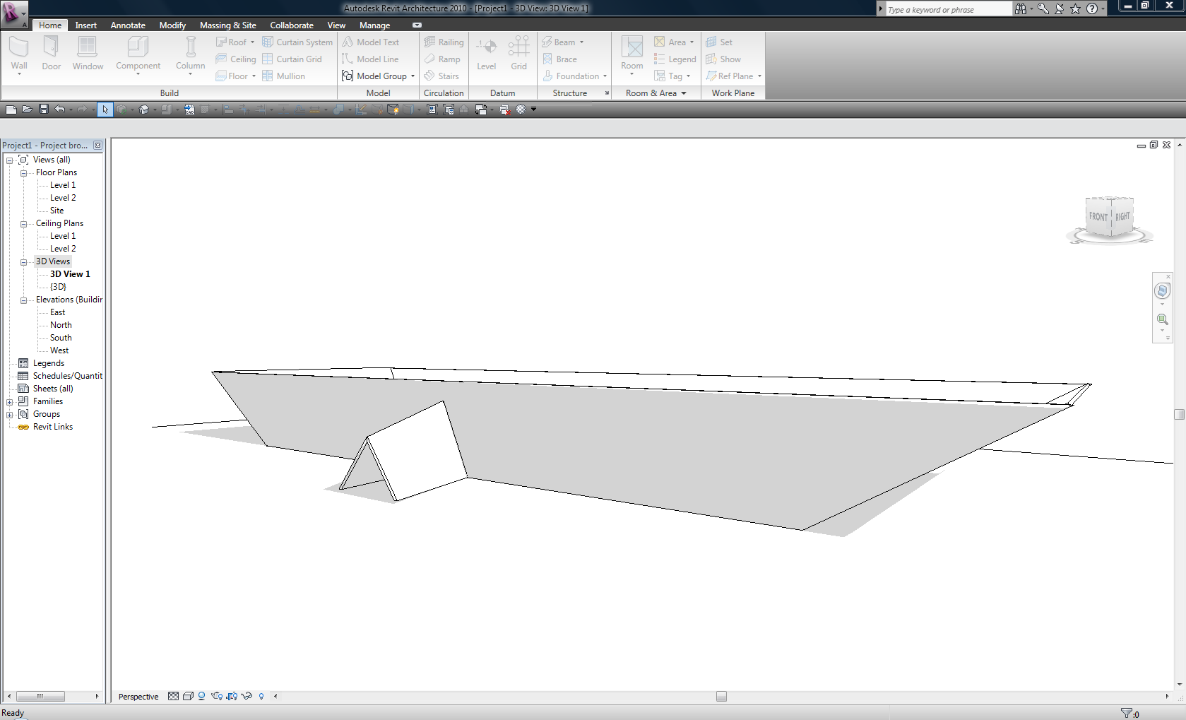

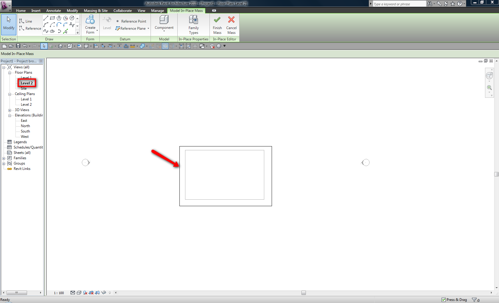

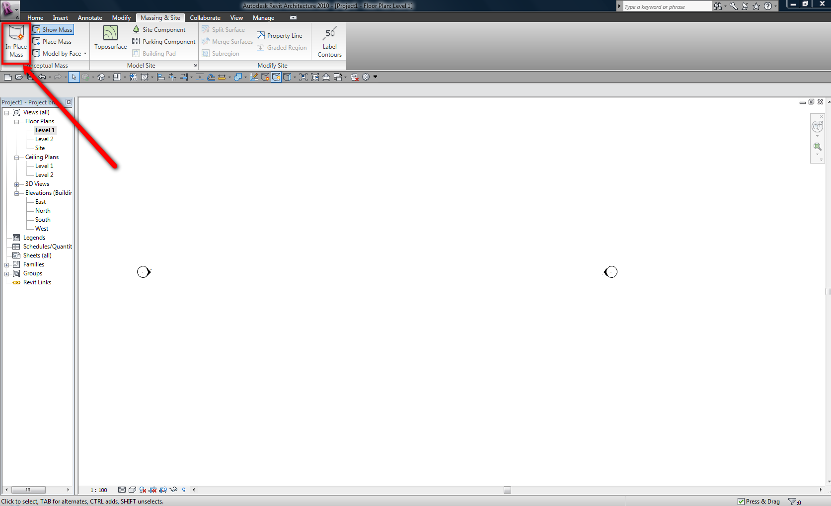

OK, try this other way, in your project, go to Massing & Site-->In-place Mass. In your first level draw a rectangle then go to the second level and draw another rectangle but with the displacement you require. Select both rectangles and pick Create Form-->Form-->Finish Mass. Now go to Home-->Wall-->Wall by Face and pick each sides....
Edited on: Wed, Jun 24, 2009 at 11:29:29 PM
61769_2009-06-242214.png61769_2009-06-242215.png61769_2009-06-242216.png61769_2009-06-242218.png

ok great, is it the same method for the triangle part? also how does the family sort of massing work, i cant work it out and thats how you create those free form kind of shapes?
Thu, Jun 25, 2009 at 11:08:21 AM | angled walls
erland73
erland73 Avatar
Joined: Fri, Sep 7, 2007
738 Posts
4.5 Stars: 85 Votes
"is it the same method for the triangle part?" ...Yes, here's a link for you to learn something about the new Conceptual Masses in 2010....http://designreform.net/category/tutorials/revit-tutorials/
