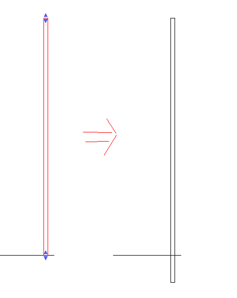

Hi!
I have managed to make my columns stretchy with arrows when I load them to my project. But now I have a problem when I stretch them.. If I try to stretch them they always grow under the plane I have it on.. and I cant move them up. Any idea how I can make this work?

That depend like the family was created, you must attach the bottom of the column to the level mark (in the family)....

Thanks! But now it's bounded to the plane.. I want to be able to stretch it i both edges..
