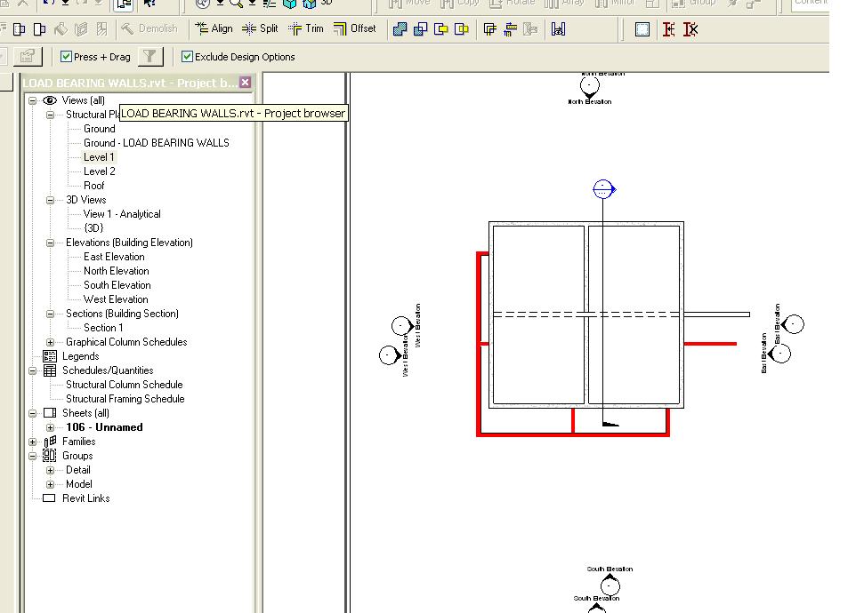

Hey, Im trying to find a way to solid fill and wall which is under do resemble a load bearing wall which is under. Is there a way to do this with using a filled region? Any advice would be much appreciated. Thanks

without using a filled region**** thanks

See this video from Rkitec :http://gibsonhh.info/revit/video/filterPoche.swf

Thanks for the reply. i have made the filter, if i want to put the load bearing walls on the seond floor plan, i put the two plans on the sheet, one on top of the other, but they seems to be blocking each other out, i have also set my filter on transparent, and this still doesnt seem to be working. Any suggestions? If you could have a look at the file ive attached, i would be greatful.

Heres a snap shot of what is happening. Ive offset the plans to show the problem. The red walls are the ground loadbearing walls, the other walls are the Level 1 walls.
