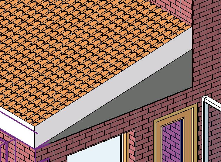

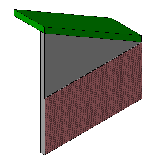

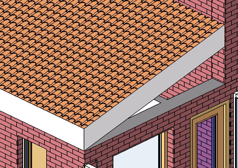

Hi, Having some degree of difficulty in attaching my wall to my roof. In fact, the attachment goes fine but instead of getting a brick in-fill, I get a grey shaded area instead. Tried all options that I can think of, i.e, adjusting properties settings but I can't seem to lose the grey shading. Any ideas anybody on how to stop this and get the brick to show instead o f grey shade?
Images attached if they will help.
 Many thanks
Kirk

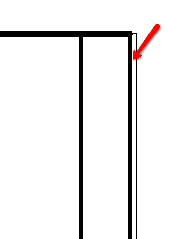

It seems like your roof is not aligned with your wall....

thank you erland73, I checked the file over and over and discovered that you were right. The roof was not aligned correctly with the wall. Must have overlooked this in the footprint. Anyhow, I zoomed right in so that I could see the lines better and corrected the problem. All OK for now anyway.
