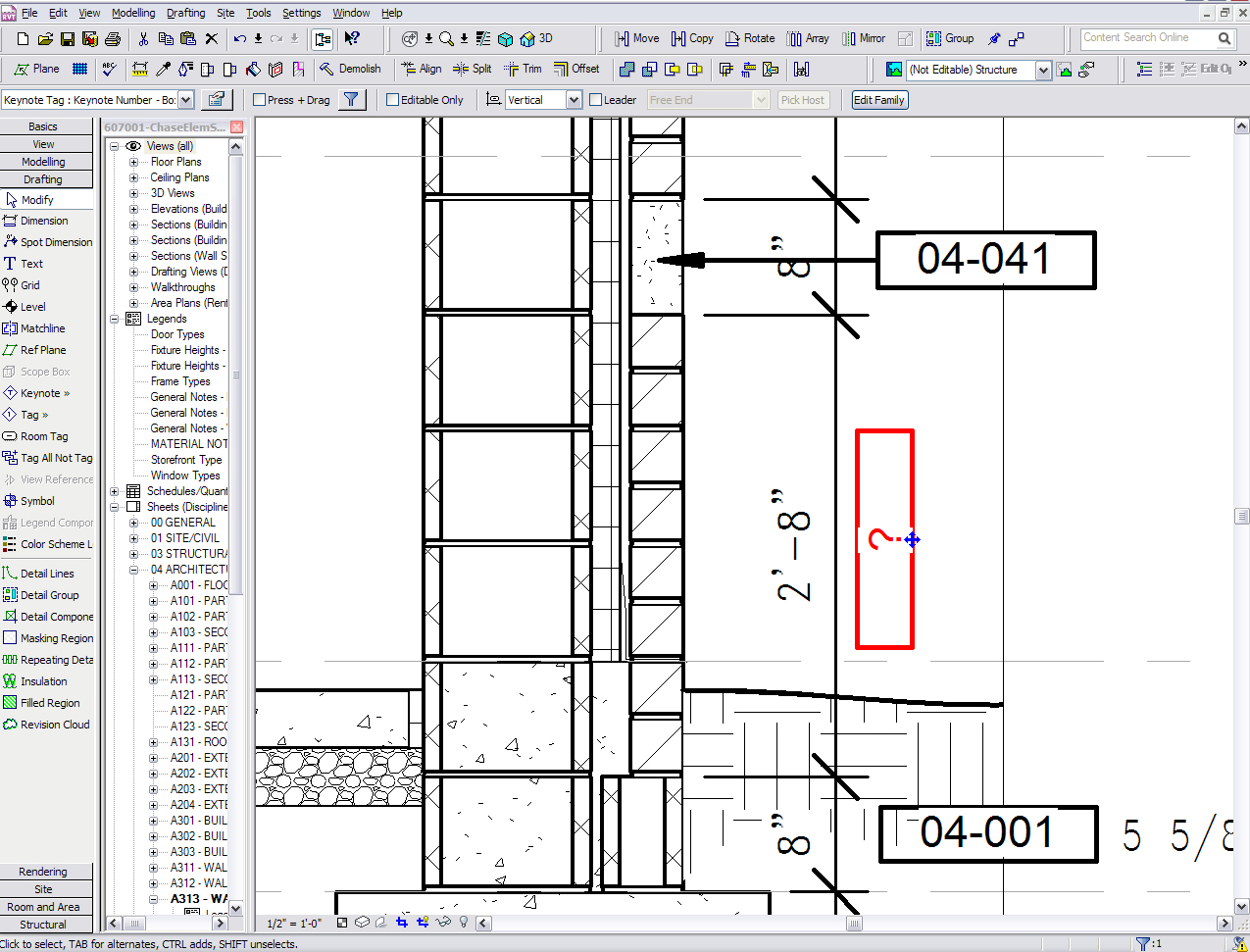

I am trying to use the Material Keynote tag in a dimension string to show the length of a certain color a brick.  The color of brick is built into the wall.  The problem is when you use the material keynote tag it MUST have a leader attached or you get a question mark in the box.  See attached image.  You can use a User keytag but that eliminates the parametric quality of the keytag.  You can use the Element keytag but that will tag the entire wall essembly.  Essentially I need an invisble leader for the Material Keynote.  Is this possible or does anyone have a workaround?
 Thanks in advance.
-Tim
