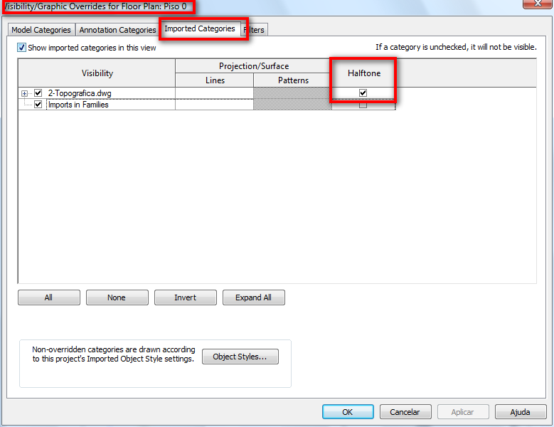

??? IF I IMPORT A AUTOCAD BACKGROUND IN REVIT WHAT IS THE BEST WAY TO "SCREEN" IT SO IT WILL PRINT  SHADED GRAYED??
Tue, Jun 23, 2009 at 9:52:55 AM | SCREENING BACKGROUND IN REVIT
Joined: Tue, May 22, 2007
5921 Posts
4 Stars: 205 Votes
Did you try to put the "backgroud" in "halftone" and print?
Tue, Jun 23, 2009 at 10:07:19 AM | SCREENING BACKGROUND IN REVIT
jetfavre
Joined: Fri, Aug 22, 2008
25 Posts
yes i did i had to set it to halftone then make it real light to work. about 40%
thanks.
