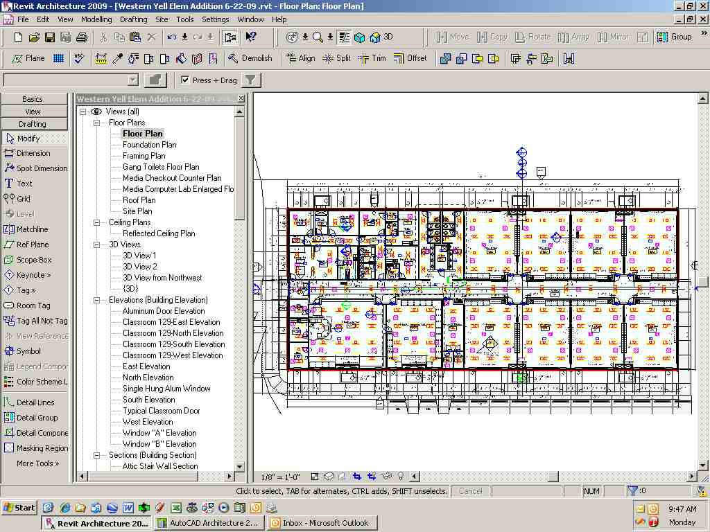

Wierd Stuff No. 1-See attached image.  After exporting the reflected ceiling plan to .dwg for the engineers, I opened my floor plan and found the reflected ceiling plan in wierd colors (ceiling grid blue, section marks green, etc.) inserted in my floor plan.  I clicked on the blue grid and selected that "insertion" and deleted it.  Floor plan now normal.  What gives with that?
Wierd Stuff No. 2-In my elevation sheet view, I activated one elevation to adjust some section marks.  After I deactivated it, I could no longer selected that elevation on the sheet view.  No box highlighted when the cursor touched it, nada.  I deleted the elevations sheet, created it again, inserted all the elevations and everything is normal.
After bragging on how stable 2009 had been, when I switched this project to 2010 and had repeated crashes, I am now wondering if there are gremlins in this project.  I did copy a previous project that was very similar and have adopted it for this one.  But I have been working on it for several weeks with no problems until now.

#1 What you deleted sounds like a CAD import.
#2 - I have seen sheets become corrupted.  That may have happened and your solution is what I would have done.
#3 - Read other posts heren and AUGI about 2010 stability.  Make sure you have the correct hardware and drivers.

OK... If I have to be Holmes..... listen Watson ... It probably was a reloaded already linked file.... I bet you exported your ceiling plan to the same name ... right?  That explains the colors - I bet those are the colors in your export - right?

Oh contraire...............................the export is what it is in Revit which, at least for me, is always a black on white image.  When you import CAD files, you have the option to keep, invert, or black and white those stupid Autocad multi-colored lines but I didn't import nuthin.  Maybe Revit did without permission, or at least the gremlins that jack around in my computer might have.
